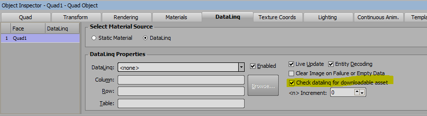

    Yes this feature was implemented in XPression 8.5 of XPression, you can set datalinq for a quad and have it check for downloadable assets.
