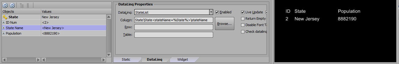

  • 4.  RE: Use Visual Logic to search though datalinq
    Posted 03-27-2020 22:27
    Sorry for delay. - So I retyped your XML information into XML notepad to make a local XML file.   Makes it tough to not have the original.  You will see what I mean with Datalinq Key to add in the state name in order to type in a name and then pull that data.  There are newer features in v9.0 that allow you to do text macros that might be helpful for something like this.
    Let me know if this makes sense or not.  I added to your list by typing out to 5 states just to make sure it works, and it is working on my end.
