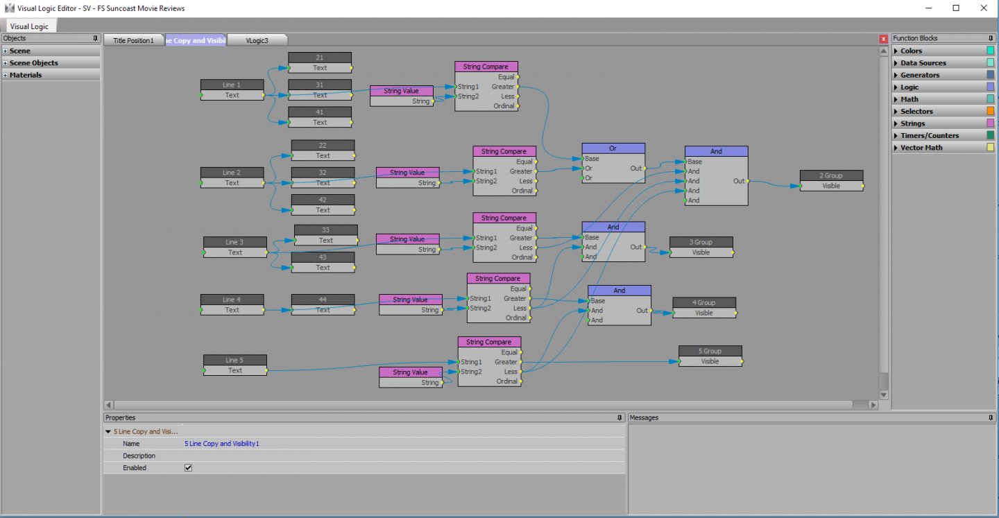

    Here's a 5 Line scene I have that doesn't work correctly. If you go into the "5 Group" group, I entered text on "Line 1" starting with a quotation mark, and as you can see, nothing shows up. If you start entering text on the "Line 2," "Line 1" will appear. If you take the quotation mark out of "Line 1" it will also appear.
    I'm running version 5.7, build 3064
    https://we.tl/L6yde3CGMs

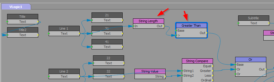

    The problem is in your visual logic. You should be using the "String Length" block and "Greater Than" block to determine if there is text in a line.
    Your visual logic was using a String Compare and checking if the text was greater than the string "0" in order of the ASCII table. So any letter would be above 0, but any special characters would be below 0...
    See my changes below; I only changed this for the first line; so you will need to fix all the other lines.. In the Greater Than block; make the Base value 0.

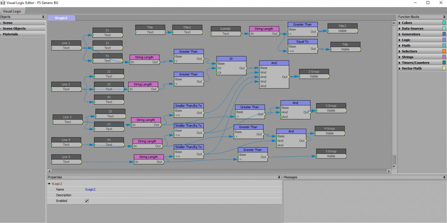

    Thanks! That worked, though it took me a while to figure out how to make it so the other groups were not visible when the larger groups were supposed to be. For example, when I first started changing things all the groups were visible. I ended up with the attached screenshot.
