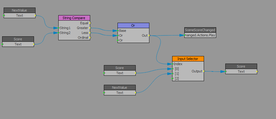

When using visual logic you need a way to rewind the scene director. It's not easy because you get into conflicts.
I have managed it with a clock widget before but script is much easier.
Place this onSetText on your text object.
dim sd as xpscenedirector
scene.getscenedirectorbyname("your director", sd)
sd.playrange(0, sd.duration)
sd.autostop = true

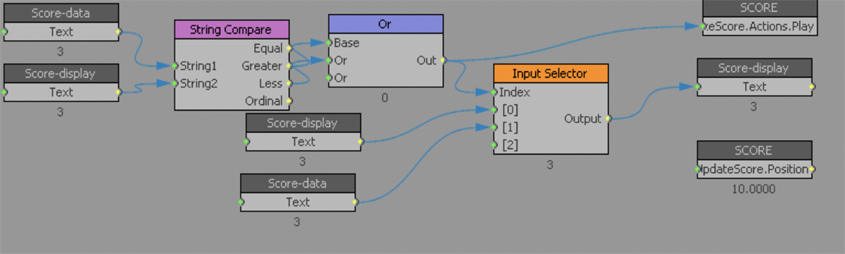

UPDATE - I figured this out, kind of. I have the UpdateScore scene director trigger a 2nd scene director that has the display full, and that 2nd scene director stops the UpdateScore scene director at the end. I also had to add a trigger in the UpdateScene scene director to stop the 2nd one that I added. That allows the scene to play correctly in the sequencer. Right now, it does 0%-100% opacity as soon as the score updates. I can't figure out how to build a delay in visual logic so that when the score changes, it will play the scene director and wait X frames before updating the display text to the new score.
Reviving this thread, as I'm having trouble getting this to work and I'm hoping someone can help me out. I've got a scene that has 2 text objects: Score-data is pulling a score from a widget (will be Datalinq eventually, testing with a widget though), and is hidden. Score-display is what shows. I have a scene director titled UpdateScore that I want to run, and it simply does opacity 100% to 0% over 7 frames, then 0% to 100% over 7 frames. I want the old score to update at the mid point (7 frames) when the text is hidden. I'm trying to use the Visual Logic example above, but I cannot get this to work, and I can't figure out why. I've changed the scene director to only do the 0% to 100% opacity, and I've seen it work once, but then it doesn't work further. I tried adjusting the Scene Director position to 0, to no avail.
It will work in layout all day long, but when I put the scene in a sequence and bring it online, it only plays the scene director once when the scene comes on, and any updates just cut.
