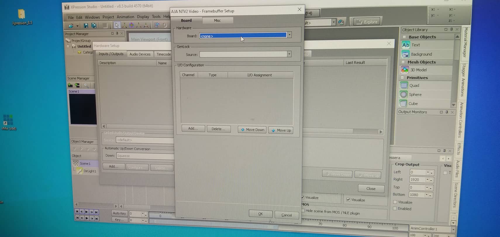

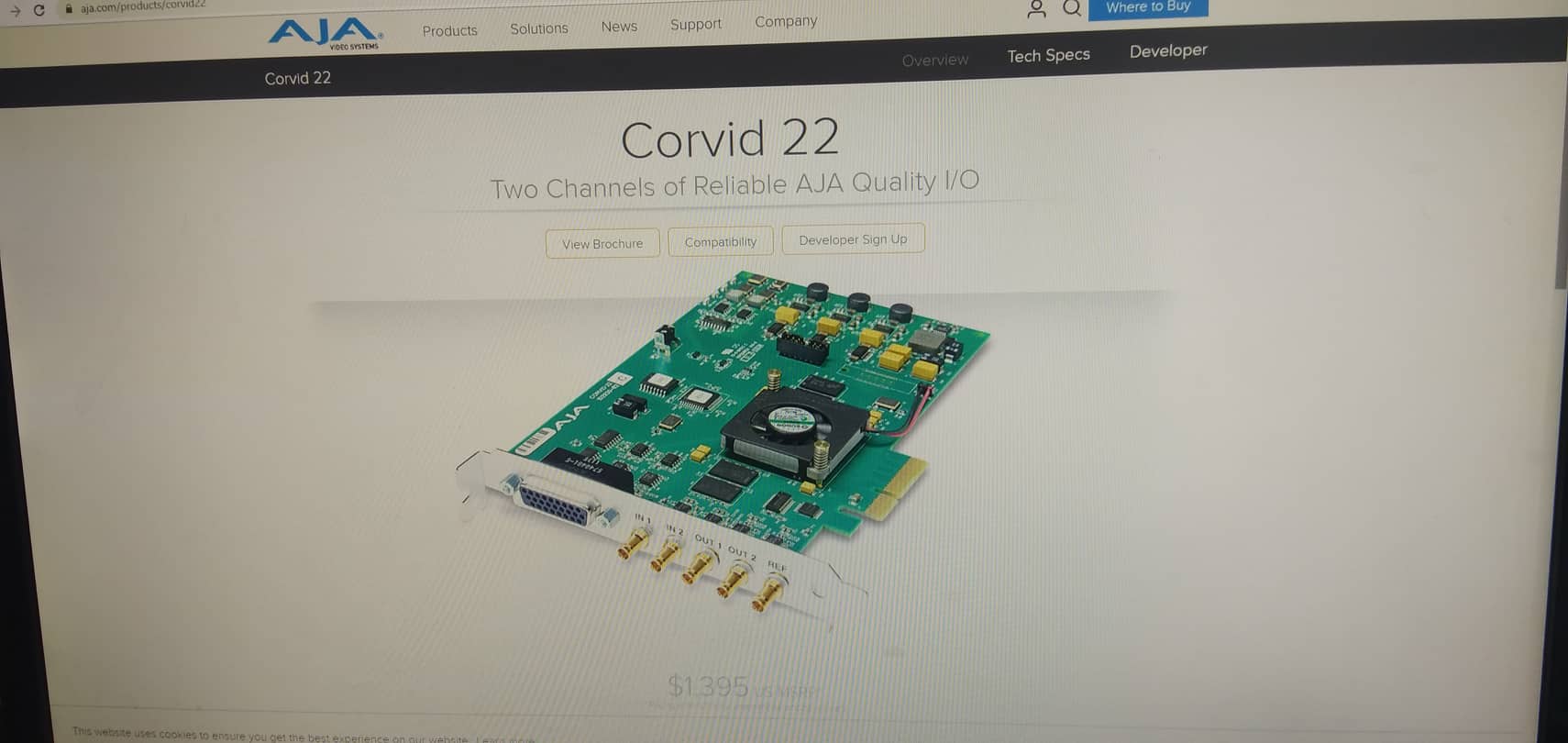

    Hello Experts,
    We are building Portable Xpression Studio with Aja Corvid 22 With HP system Z440. we didnt get any driver software from vender for Aja corvid 22 . so there is not any list for Aja Corvid 22 in Hardware Selection menu in Xpression.  how can i solve this ?

    Hi!
    The drivers for AJA Corevid22 are on ROSS's USB dongle provided with software.
    Also if you have a key shift issue you have to update the firmware too.
