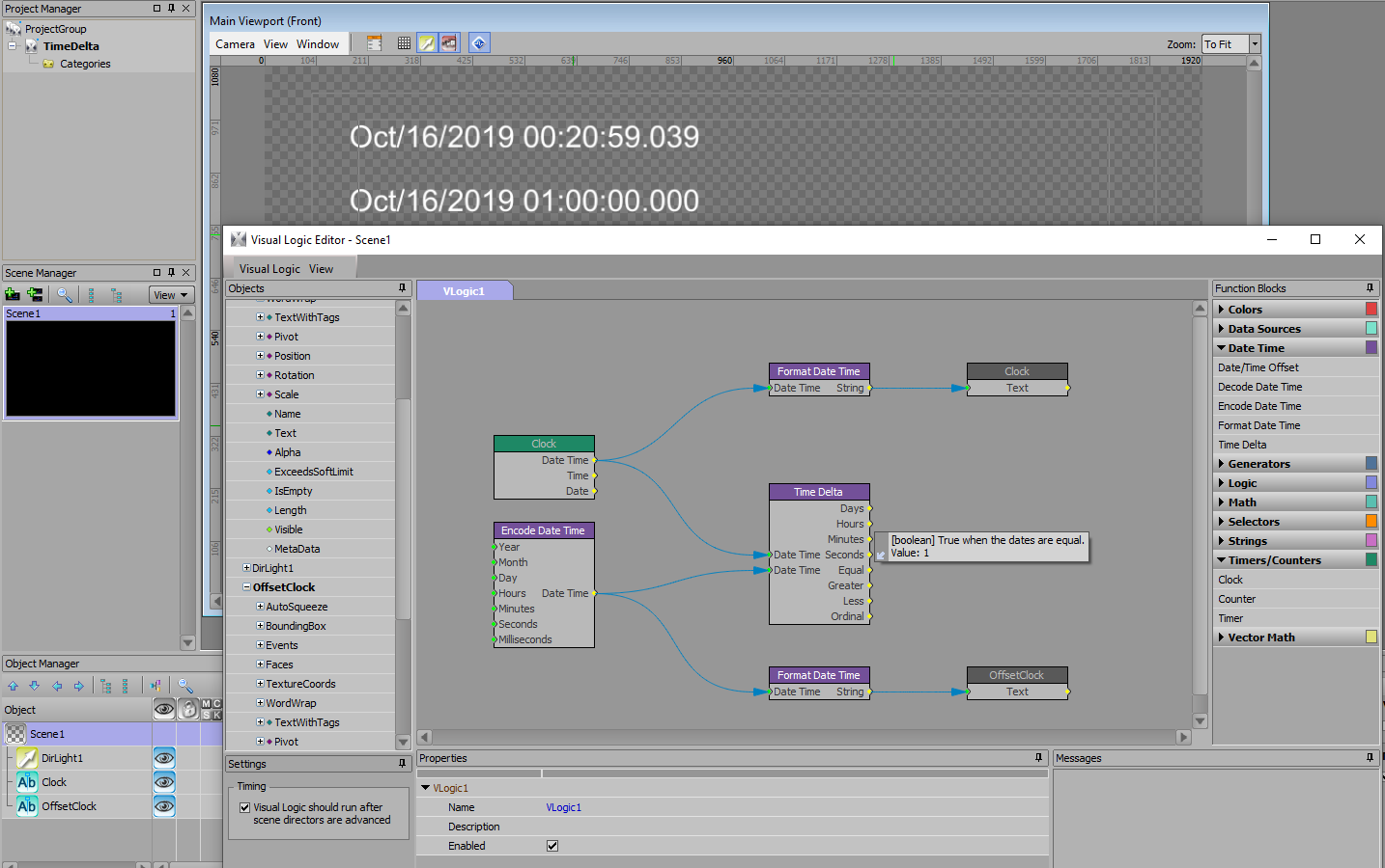

    I was playing around with the updated Equal/Less/Greater -feature in the Time Delta-block in Visual Logic and I think it's not working properly.
    When I'm using a clock-node from visual logic and I compare that to an encoded DateTime-block, the Time Delta is showing that the values are equal, which they are not.
    Below you can see a screenshot. I put the output of the clock onto a textobject and the same for the encoded date time. When I look in the Visual Logic, it's showing that the two Date Times are equal which they are not because there's about 39 minutes between them.

    Hey Kenneth,
    This has been fixed in 9.5.4941; I will send you the software once available!
