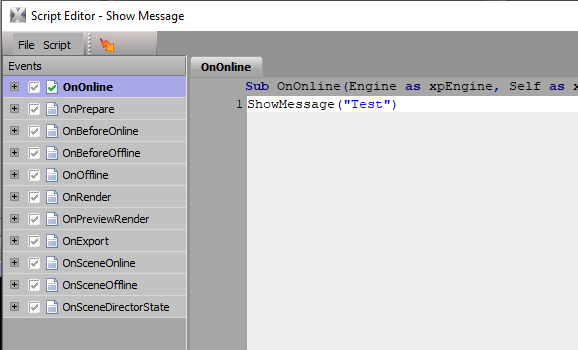

I actually don't remember the project I uploaded so instead I made a new one; let me know if this helps at all.
You will be able to see the example global methods I added in the global methods window
the below is the two methods I added;

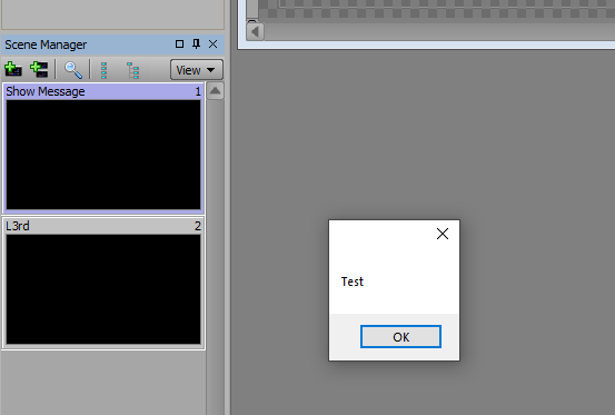

ShowMessage is a sub (Sub Procedure) which just pops up a plain windows message box to the user and
UpdateText is a function that returns a string
sub ShowMessage(inMessage As string)
Windows.Forms.MessageBox.Show(inMessage)
end sub

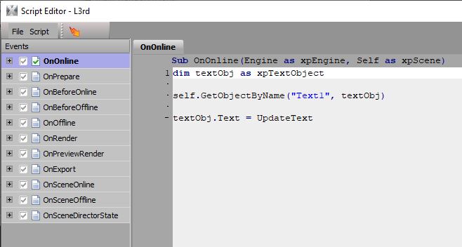

function UpdateText() as string
return "THIS IS MY TEXT"
end function

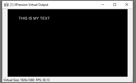

The project itself has two scenes
the Show Message scene utilizes the ShowMessage Sub
which when taken only shows the message box
The L3rd scene utilizes the UpdateText function to change a text objects text when the scene comes online
