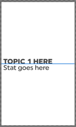

    Has anybody successfully been able to get XPression to center text vertically correctly? I've looked through the forum and have tried the Text.BoundingBox.Height > Divide by 2 (or 2.5 - seen both here) > Text.Position.Y. It works to a point, but the text always ends up being offset too high. Ultimately what I'm looking to do is attached below - either 1 or 2 lines of text with different font weights (sizes are the same) and get them to be centered over the backplate. Each line of text can itself have multiple lines.

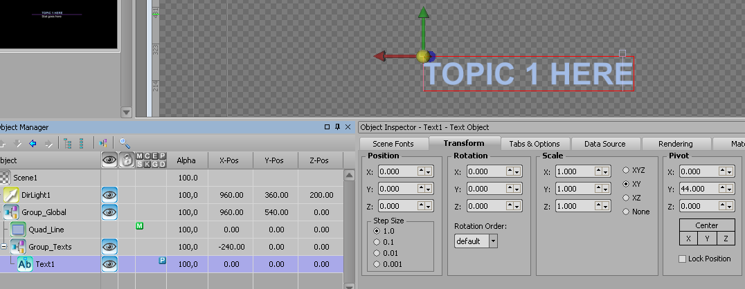

    by default , the pivot point of a text is align to his baseline : that may explain why your text is offsetted not the way you want.
    You can manually adjust the pivot to match the top of your text :

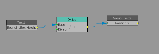

    With this done, height/2 logic should work fine :

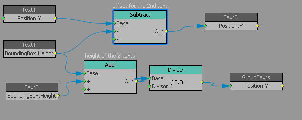

    Then you can extend your logic to take into account 2 texts .The second text is offsetted by the height of the first text :
    see sample project attached : TYT_Vertical_align_001.zip
