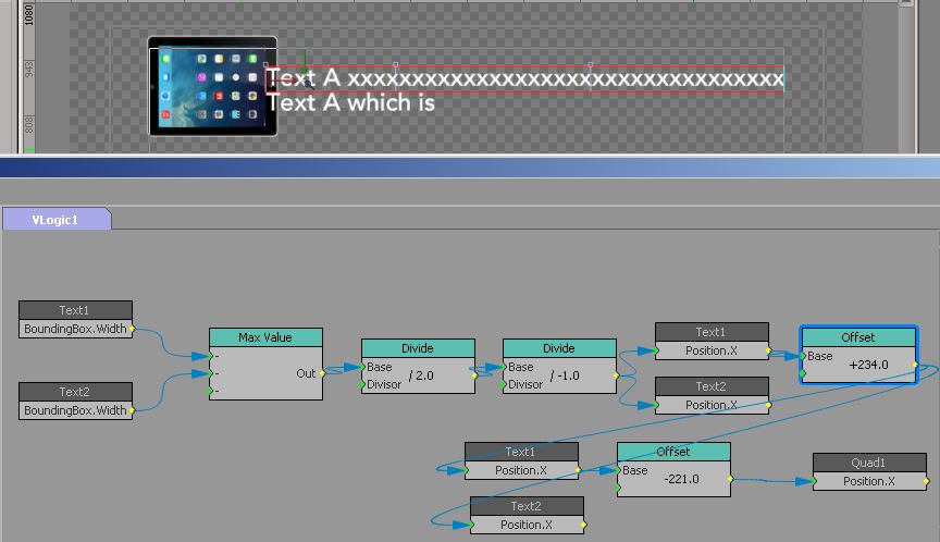

    Please help. I have 2 rows of text left justified to a quad and i want the whole group to center horizontally on x. I have accomplished this using the visual logic below, but if I turn on auto squeeze, it no longer works properly.  The text does not squeeze...and it just keeps adjusting the x position. I think I have to tell it if it reaches a certain width to stop changing the position, but I am not really sure. Any ideas? Thanks so much for your help!

    Use the boundingbox.widthscaled visual logic blocks. These will take into account the auto squeeze.

    OMG. You are AWESOME! Thank you. It worked like a charm.
