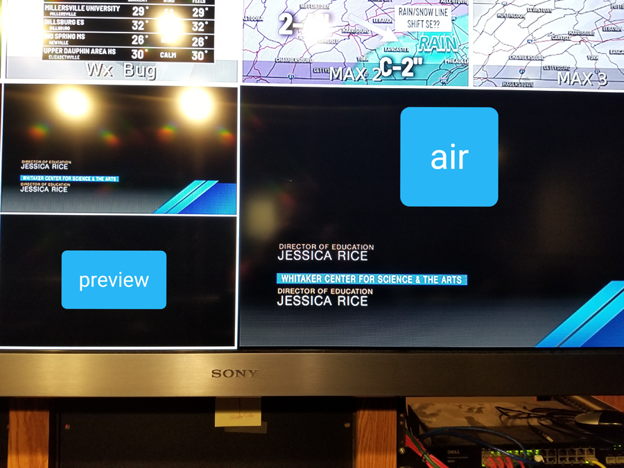

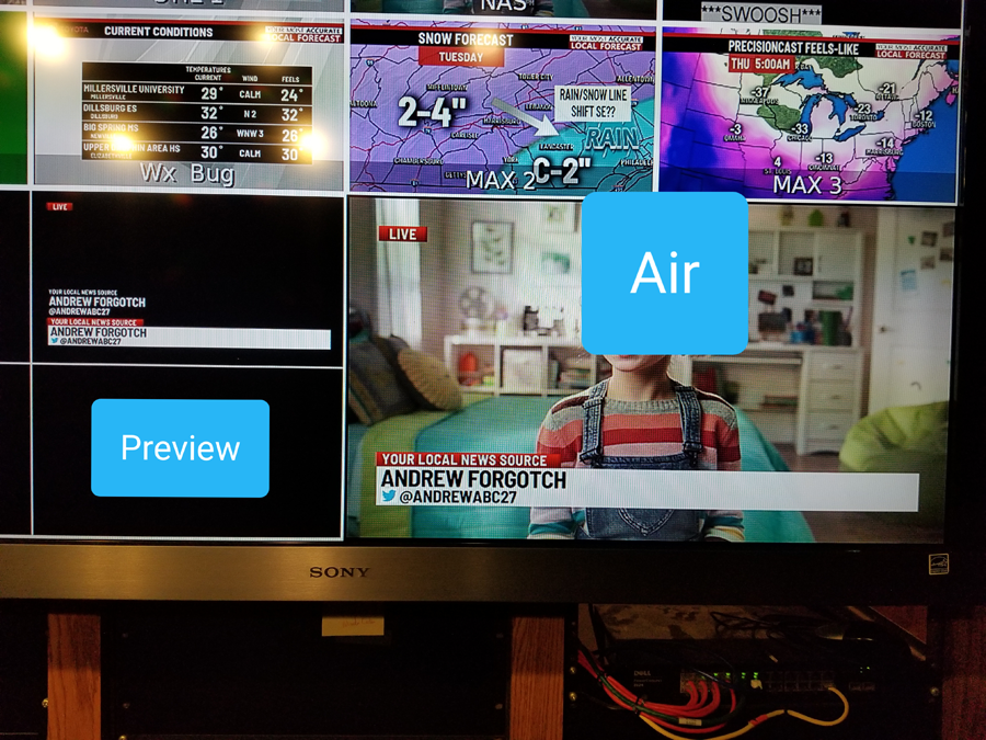

    I gave this a try and realized I should have clarified a bit further.
    Enabling 'Render in Preview Only' allows the element to be viewed in the ENPS plugin and within preview in Remote Sequencer, it does not enable to element to be viewed on our preview monitors. We provide the preview text in our preview monitors to allow our director to know the graphic has been cued up before it's played on-air. I've attached a couple of images of working preview text vs non-working.
    The graphic with the white lower third has working preview text. As you can see in the smaller preview monitor, the preview text appears above the played out graphic; however, the preview text is absent in the larger air monitor.
    In the second image, the preview text is not working correctly and appears in both preview and on-air.
    My script has been applied in the same manner within both projects.

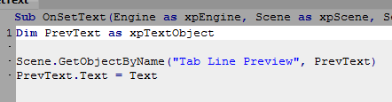

    Do your new templates (in package 2) have the text object called "PrevText" in them? Is there a script on that text object?
  • 7.  RE: Issues with preview text script
    Posted 01-28-2019 20:01
    The script for the main text layer (Tab) references the preview line (Tab Line Preview). There is not a script for the preview line.
