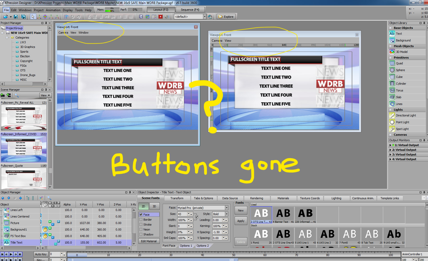

    Came in this morning to check a new scene made over the weekend by someone else.  As I was checking the transition logic, I noticed that lines of text weren't doing what they were supposed to, then quickly realized the blue diamond button must not be clicked on...
    it was then I noticed there was no blue diamond button, and in addition, no visual logic button.
    I assume the layout has somehow been manipulated so these are not there; but I have no idea how to get them back.  I tried resetting the layout, adding a new viewport, closing XPression out & reopening; but nothing brings them back.
    Any suggestions?

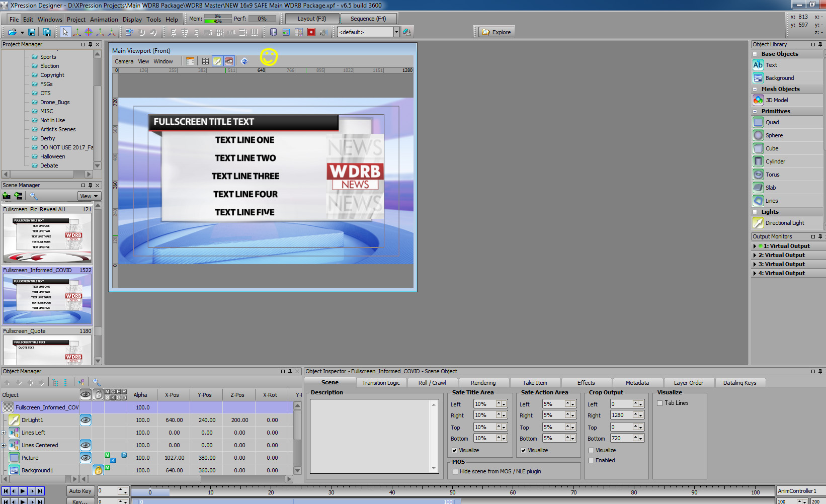

    Got them back.
    After messing around some more, I realized I wasn't seeing the main viewport in any of the windows. So messed around some more, and came to the conclusion that the main viewport must be stuck somewhere off the screen. This monitor was configured for dual-display (even though I don't have a dual-display- genius), so I reset the monitor to normal display, then the main viewport returned.
    However, I then couldn't get the main viewport to live on the main XPression layout, it would fall behind on its own every time I clicked the layout area. I then realized the main viewport had been set to floating. Unchecked that, and then all was back to normal.
