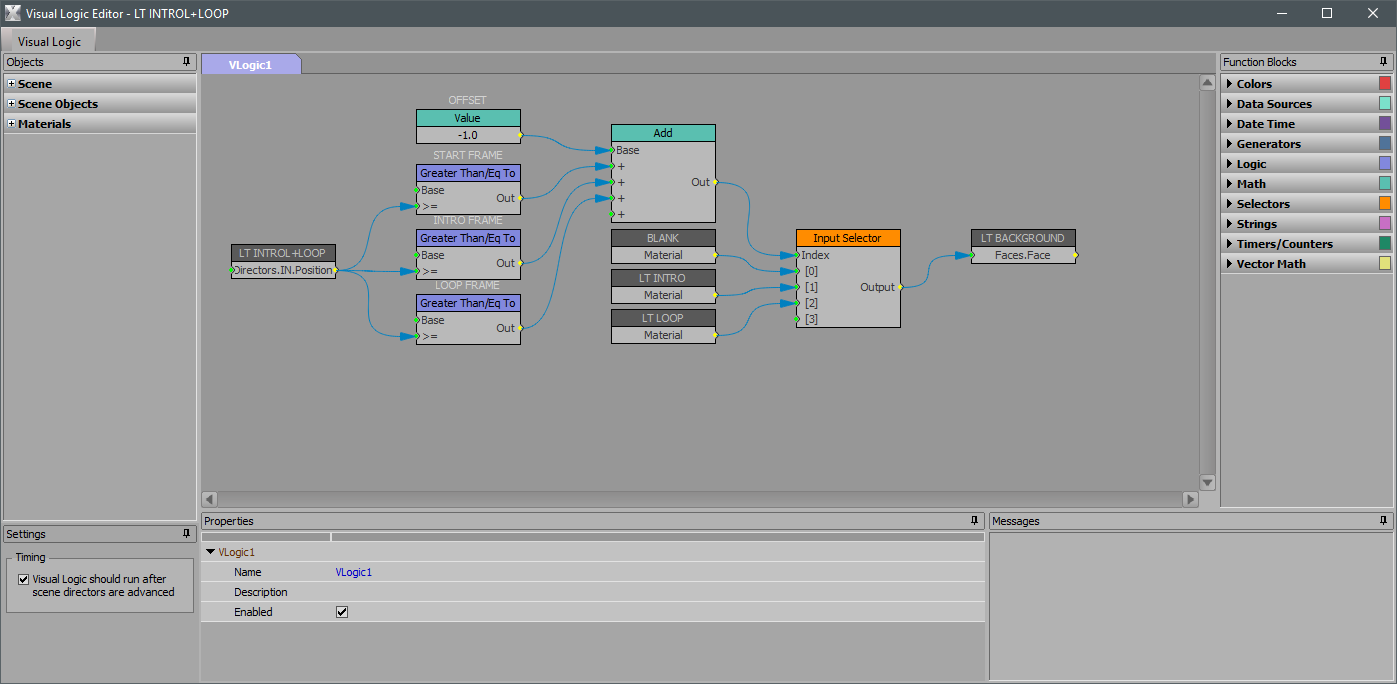

    As workaround alternative I'm using visual logic in order to map quad with 3 materials: blank/empty when intro scene start, intro clip after the first frame and loop clip when the intro animation ends.
    All materials are in Autostart and freerun.
    Do you have other solution?
