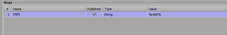

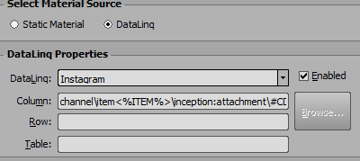

    I have a question about Inception to Xpression RSS feed. If I have a playlist of Inception tweets, how do I go about setting that up in Xpression to grab all those similar to the Rel ID where it automatically grabs all of the tweets in the playlist and fills them out? In the video example, they fill out the row data and Datalinq keys to have it fill out automatically in Sequence. Is that possible with the RSS feed/Inception playlist as well?

    Yes you do it just the same, check the Datalinq and DatalinqKey videos on XPression U, it works just the same for RSS feed just need to put the at the right point of the query in Datalinq, so if you're getting your RSS from inception that will be after the /item/ node. eg. /item/... and then use %relid% as the input for that datalinqkey.
