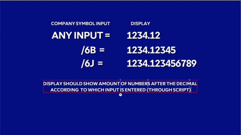

    It's actually not logos, but values from an RSS feed (values indicating net change of a stock)
    If the company symbol is /6B, I want the value to display 5 numbers after the decimal point.
    If the company symbol is /6J, I want the value to display 8 (or 9 if possible) after the decimal point.
    For all other company symbols, I want the value to display 2 numbers after the decimal point.

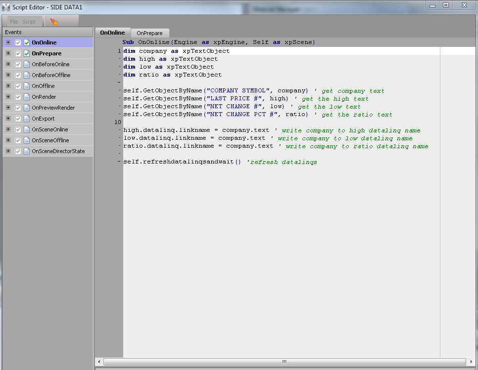

    Here are 2 snips with the script and what I am trying to do, I hope this helps.  Thank you for your help.

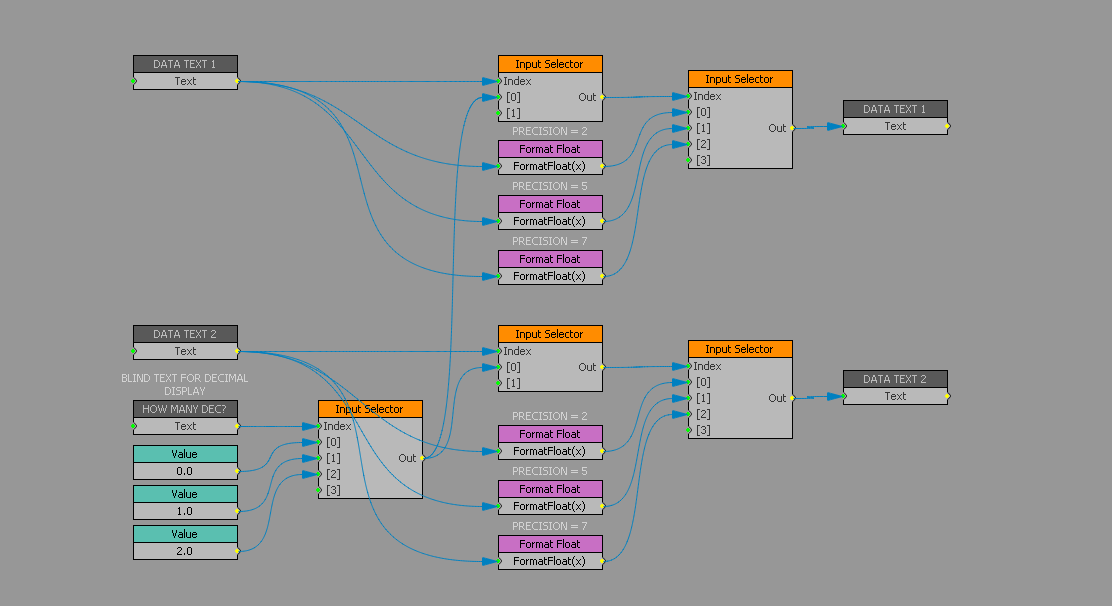

    Update:
    I was able to find a way to manually change the display of the amount of numbers after the decimal point by using Visual Logic and a "blind text" input. This will work for me for now, but I would still love to find a way to use either Visual Logic, scripting or both to allow a producer to just type in the company symbol and have the text field display the corresponding amount of digits after the decimal point.
    (Corrected Visual Logic added at 12:44pm Central)

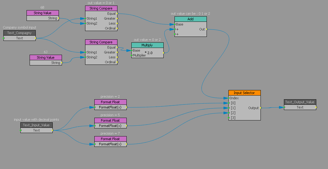

  • 11.  RE: Visual logic for various decimal point values
    Posted 08-20-2019 16:48
    Hello Mark,
    good work with your visual Logic.
    Starting from what you have done, here is maybe a way to do the switch test from company input value :
    Hope it helps.
  • 12.  RE: Visual logic for various decimal point values
    Posted 08-22-2019 13:54
    Malcolm -
    I put this script in but I'm sure I'm not doing something correctly because I couldn't get it to work. Looking at the script, however, it looks like I would still need to input a number (amount of numbers after the decimal) to display.  If that is the case, I think I will opt to go with the Visual Logic that I figured out only because I am much more familiar with it and comfortable if I would have to make any adjustments in the future.  Thank you very much for your time and effort in helping me with this matter. I truly appreciate it.
    Mignon -
    Thank you as well for this example of Visual Logic.  I worked with it a bit, but again, I am more familiar with how I made my example.  I will keep this as a snip and if the situation arises, will use it.
