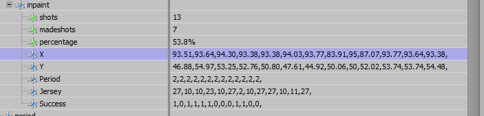

    NGSS sends shot chart data like this. Does anyone have a script I can use to "tear apart" the x and y data so that I can assign them to object x and y for a graphic representation of shots on a shot chart? Thanks in advance.

    Pretty straightforward, you want a Split() for this since you've got the data formatted pretty nicely. This script is working off some assumptions, that both your X and Y values will have equal amounts of entries, but I imagine they will. It also assumes that commas will only ever be used to delimit your data, and there is no whitespace between a number and those commas.
    Map that datalinq source to hidden text objects in your scene. Name them XVal and YVal (or whatever you want to call them, just be sure to update the fields in the script) and then you're good to go. It just runs a loop based on the total number of indices it created while sorting through the commas. A Split isn't enough since it will return a string, so the For Loop is there to convert it to double data type. If you need to test the values it's returning, just un-comment in the loop below so you can check the debug monitor. More notes after the script.
