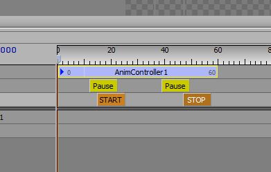

  • 7.  RE: Counter widget start on second Take?
    Posted 04-24-2019 22:02

    Actually, with some trial and error and your last screen shot, we managed to make it do what we wanted (the secret? Compile). Appreciate all the help! On to the next issue.
