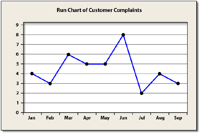

    Hello Experts,
    Is there any way to create this kind of chart in xpression throught excel data ?
    Thank you
  • 2.  RE: Run chart , Run graph
    Posted 06-23-2019 01:47
    Hello Sunil,
    Well there is a ways and there isn't.
    You can create charts like this using the Lines-primitive but then you have to do it manually.
    Another option is to use the API-texture in the materials but then you have to script it.
    There is no out-of-the-box solution with Datalinq for example that is capable of doing this easily unfortunately.
    Sorry
  • 3.  RE: Run chart , Run graph
    Posted 04-14-2020 15:29
    Hi. I wish to share you a project that has two scenes with animated data driven line charts. It can have some errors but is usable. Feel free to use it as you want.
    https://github.com/nicolasjuan/xpLineChart
