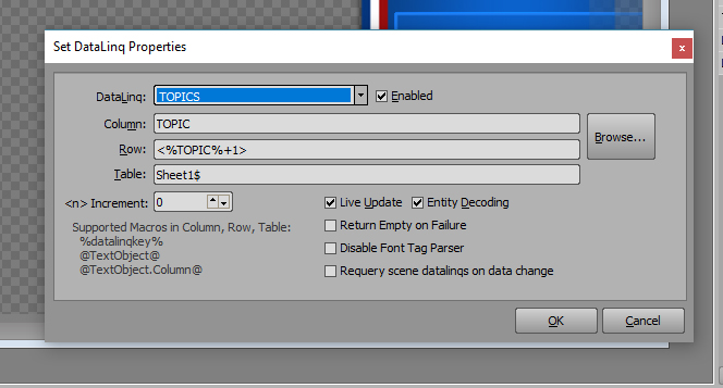

    I am wondering if anyone knows how or if this is possible. I have a 'topic bar' that I have created and I would like to link the topics to my Excel sheet, but I would also like to be able to change the Datalinq information fairly quickly. I envisioned something like this:
    Topic 1: linked directly to the Datalinq Key (using the %text% macro)
    Topic 2: linked to the Datalinq Key, but adding a "1"
    Topic 3: linked to the Datalinq Key, but adding a "2"
    The goal is to be able to change the top topic from a certain range (1-20) and each topic below the top one would be sequential. Any ideas?

    Solution (Thanks Rob Rowe)
    Datalinq key: text
    Topic 1: %text%
    Topic 2: <%text%+1>
    Topic 3: <%text%+2>
