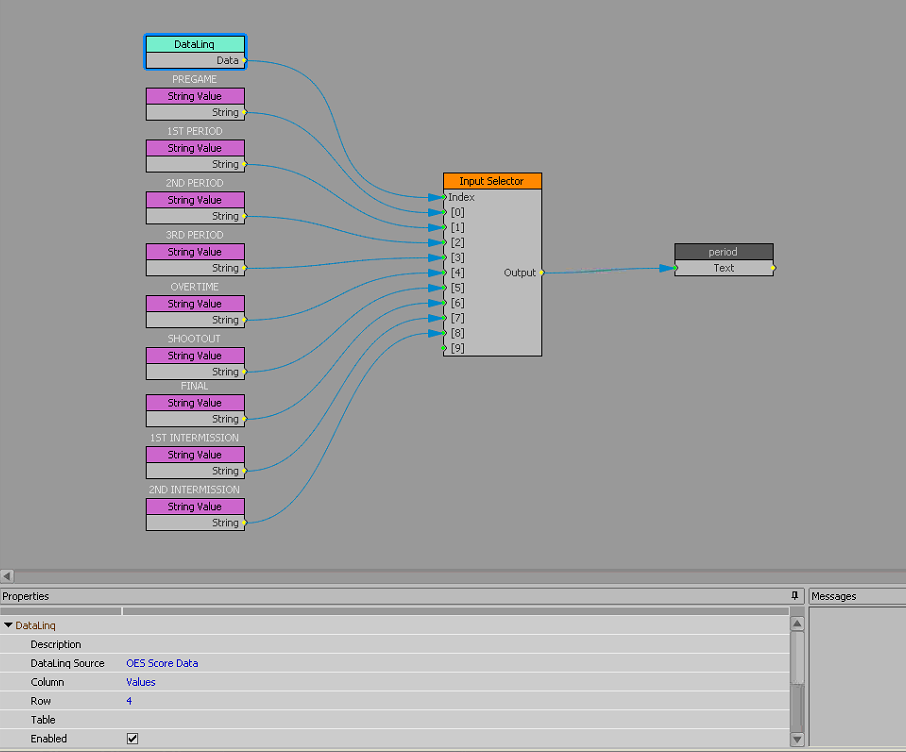

    When receiving Data from the Daktronic All Sport, they give you values of (1,2,3,4)
    With Visual Logic, how do I tell them scorebug that when Daktronics gives me that data, that I want it to say (1st, 2nd, 3rd, 4th)
    So
    1=1st
    2=2nd
    3=3rd
    4=4th
    Thank you in advance.
  • 2.  RE: Scorebug Quarters Data from Daktronics data
    Posted 01-08-2020 19:05
    See screenshot below. This is visual logic that translates period data from OES into logical text. Top left box is the data filed from DataLinq. String Values are logical text that run thru the input Selector. If index input (datalinq) equals '2', then output will equal String Value on input 2. The box on far right is the text box in your scene. Hope that helps.
