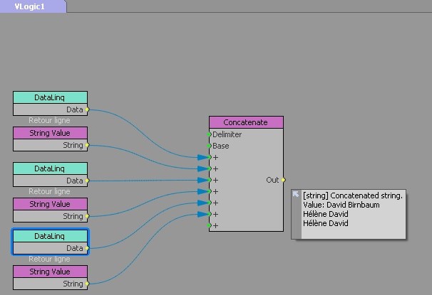

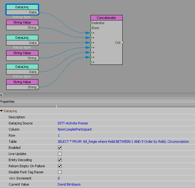

    Here's my datalink and my Scene

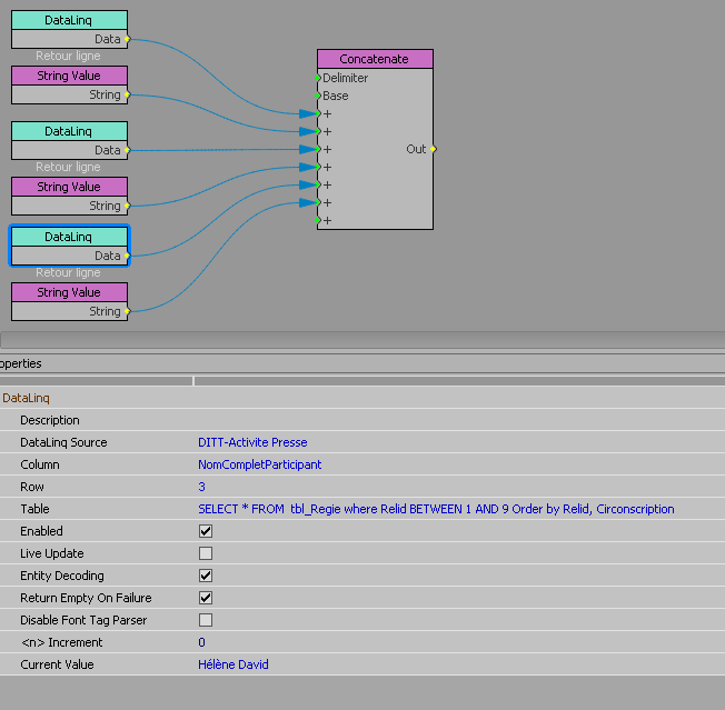

    On the datalinq itself, you will also need to enable "Return Empty On Failure" if you want it to blank the field when you are requesting a "row" outside of the valid range in the datalinq.  The "Wrap Inidices" checkbox only stops the datalinq from wrapping around and returning the earlier rows.

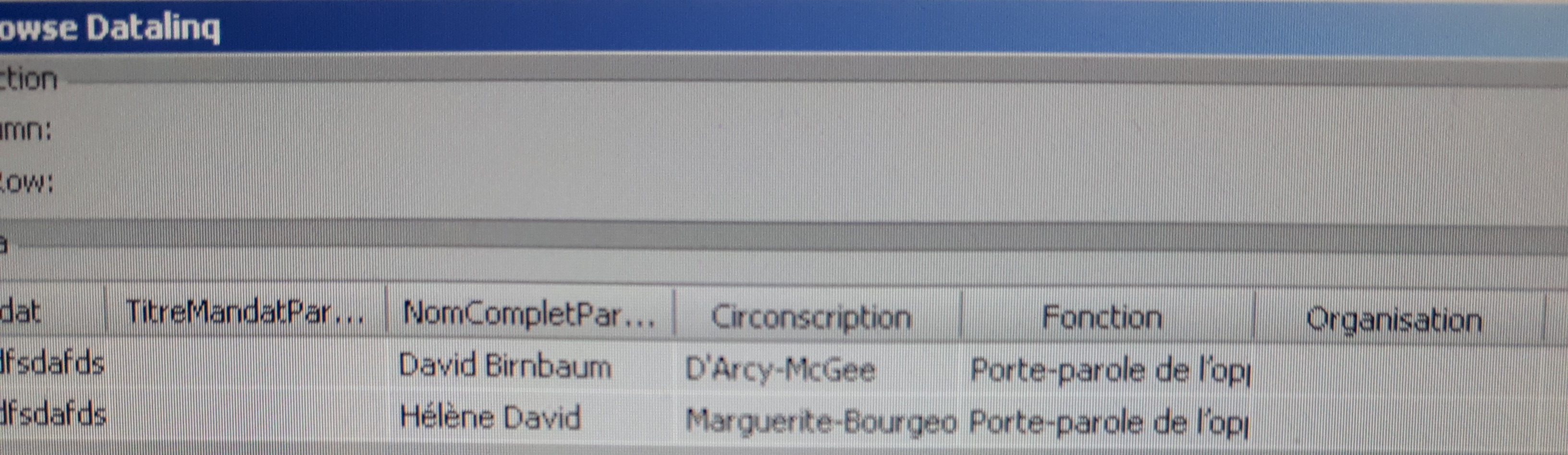

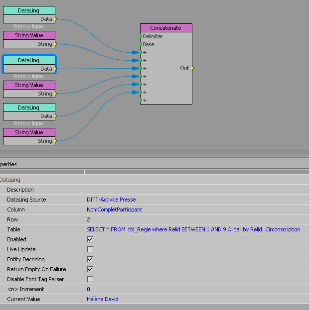

    Posted 07-02-2019 14:50

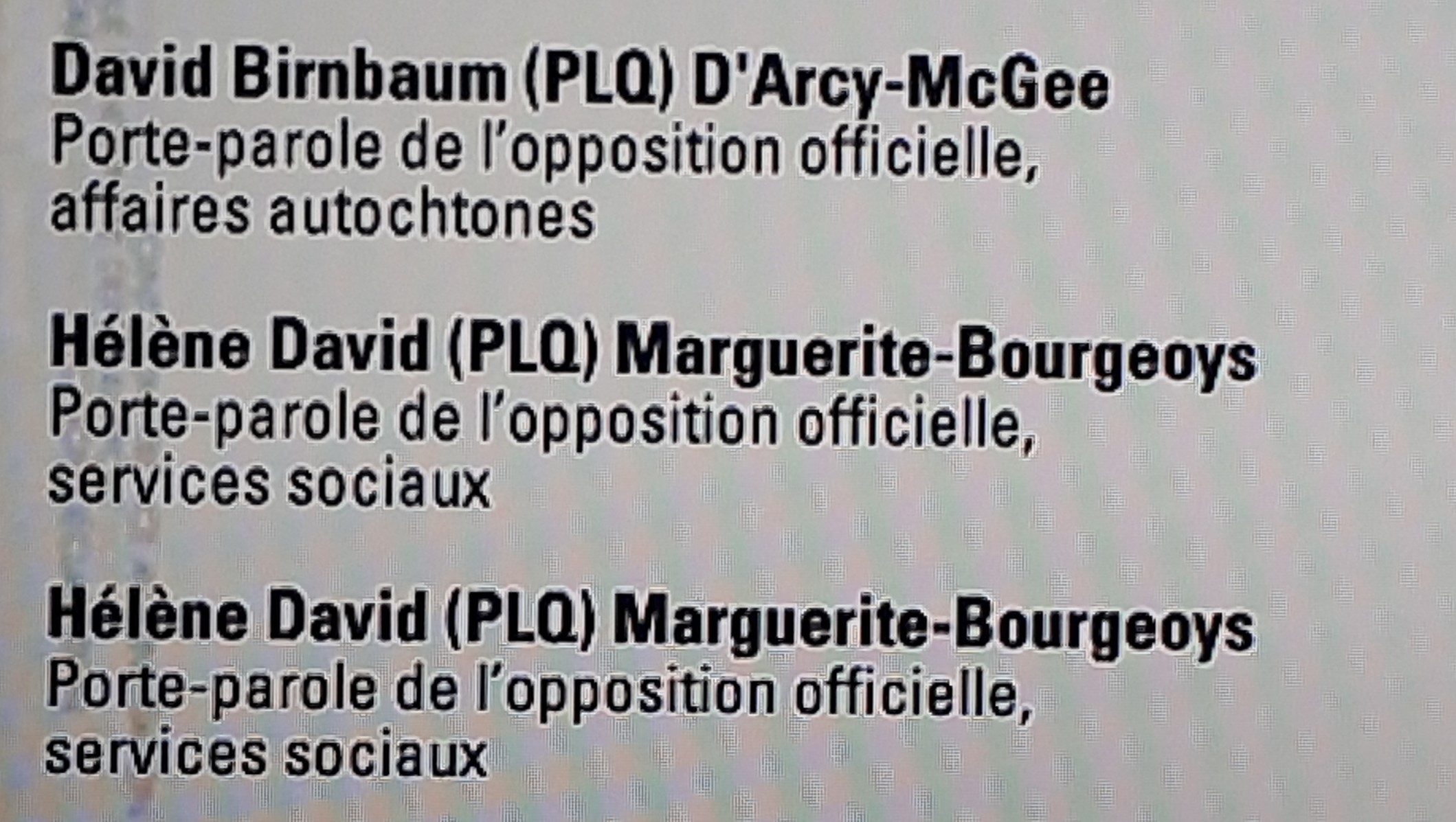

    It was enable. I've try on another scene to simplify, with same value (two names) where Row 1 = David and Row 2 = Helene.
  • 7.  RE: Xpression Datalinq Server repeat last "values"
    Posted 07-02-2019 14:51
    As u can see, row 3 still equal Helene…
