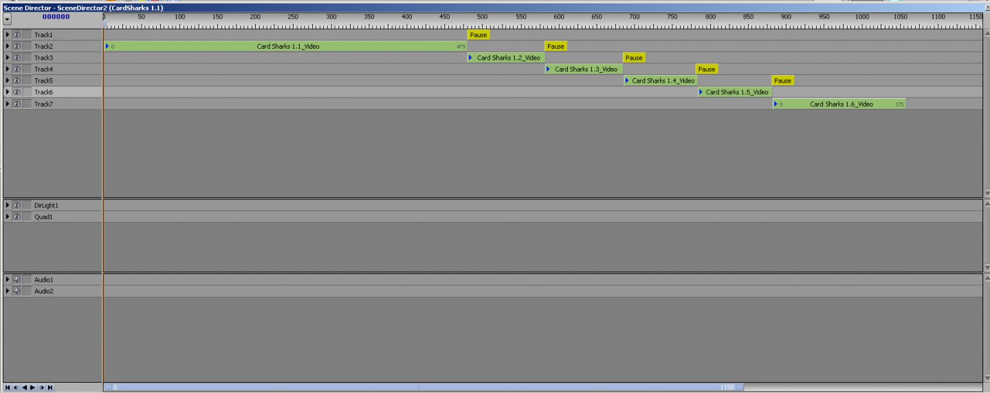

    I have a game I am trying to setup with one scene using pauses, but I can not get it to work quite right.
    I have 6 different videos, each one revealing something new, however the pause in between could differ because of crowd participation so Instead of buiilding it into the graphic I want to add in pauses before each video is triggered. I tried a test and put a pause in and it did not work at all. I have the Video Materials set to Play once and auto start. Hoping someone might be able to help, or has done something similar.
  • 2.  RE: Pause Video in Scene Director
    Posted 09-28-2017 16:12
    If you put a video material in the scene director you need to turn off all the playback settings in the video material. The Scene Director will control all the playback.
  • 3.  RE: Pause Video in Scene Director
    Posted 09-28-2017 16:44
    I have made that change, but even so with everything unchecked and run mode on stop the video clip still starts even though I have a pause in front of it. It also is stuck in Transition for the length of the scene director? Any thoughts?
  • 4.  RE: Pause Video in Scene Director
    Posted 09-29-2017 04:34
    You could try dragging the separate clips into the sequencer directly. If the clips are built sequentially that should work for you.
  • 5.  RE: Pause Video in Scene Director
    Posted 09-29-2017 04:36
    Oh I forgot, if you're going to put the clips on the scene director to control them, don't select AUTO-START for your video material, that will start all your clips as soon as the scene goes to air.
