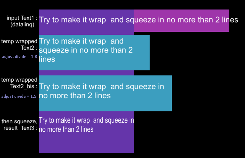

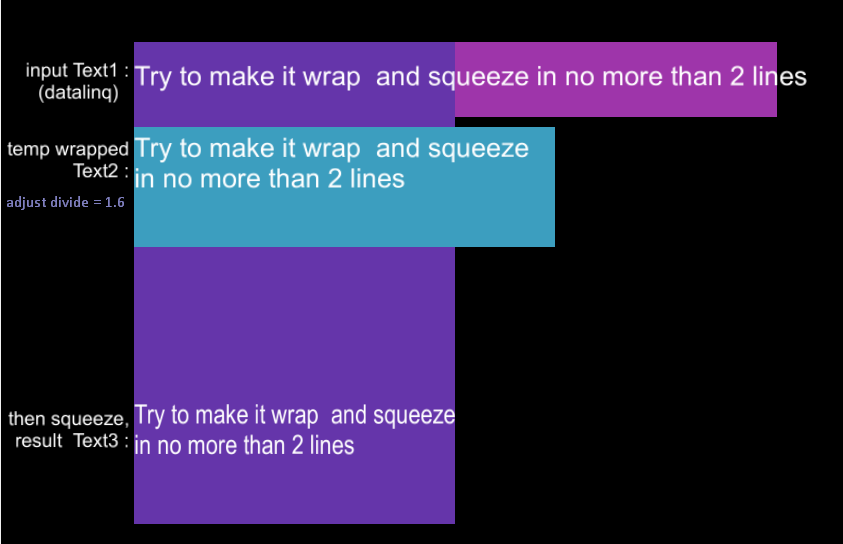

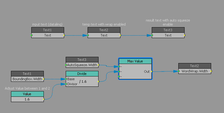

    in pure Visual Logic , you can try this :
    - "Text1" is the input text that is filled with datalinq . Auto squeeze and Word Wrap are disabled
    - "Text2" is a temporary item with word Wrap enabled.
    - "Text3" is the resulting text to be displayed with AutoSqueeze enabled
    The tricky part is to find a good value for Text2.WordWrap.Width when the input text width is greater than Squeeze width.
    The divide value to adjust WordWrap width can be from 1 to 2 .
    A value of 1 will favor squeezing over wraping
    A value of 2 will favor wraping over squeezing and will produce more than 2 lines quickly
    1.6 seems to be a good value, but it depends on the containing text.
    we can add on more test : if Text2 is more than 2 lines, try with a new adjust value on Text2_bis :
    Please note that this Visual Logic won't work everytime. And it seems that in the preview window the logic is not correctly displayed.
    More ideas are welcome to improve it.
