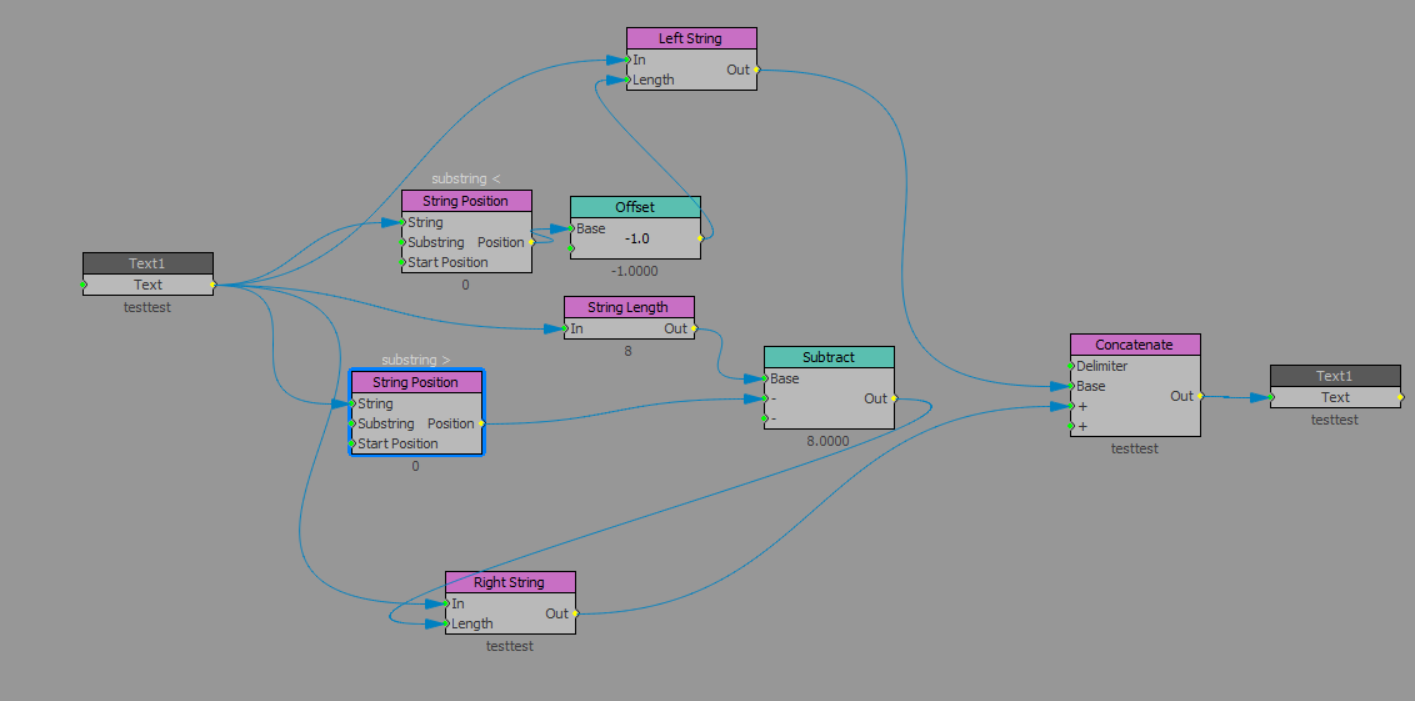

    Hi Rob,
    In VL you can try something like this :
    I don't know if it's the best solution but in simple cases it seems to work.
