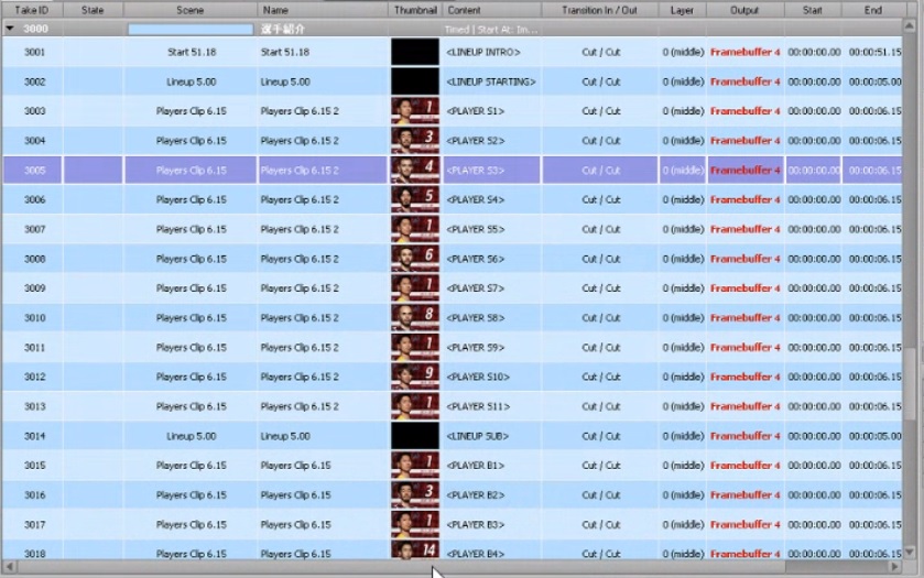

    We have a background object with material and that material is linked to a fixed cell in Excel via Datalinq.
    We assign videos by using this.
    We need to refresh them manually before the event will start, but there are more than 20 links(scenes) so we want to updates them at once so that we can see thumbnails to check.
    Here's a screenshot to make it clear.
    Thank you.
