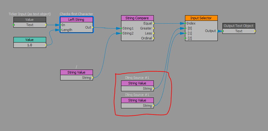

    Hmm, is there any way that you'd be able to go back to your old way of searching tickers? With how datalinq sources can be handled in 9.0 you can use macros to create a dynamic URL.
    Your example of: https://www.DATA_URL_EXAMPLE.com/rss?s=XYZ now can become: https://www.DATA_URL_EXAMPLE.com/rss?s=%Ticker% in which Ticker is simply a datalinq key within the scene (or scenes) in question. You can even go one step further and used @Value@ as the Datalinq Key source.
    To address your original question, if all you need to do is detect a "/" character this sounds like something you can do by setting up a conditional that uses an input selector to change the source of information being fed into an object. I've circled in red what you would want to swap with your datalinq sources.

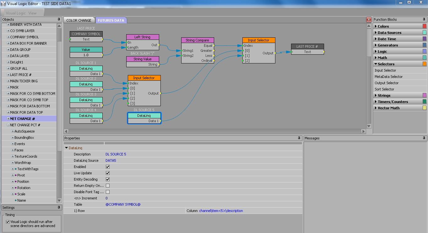

    Thank you for your quick response and help.  I tried the Visual Logic you suggested above and it wasn't working how I wanted it to work.  However, I made a few minor tweaks and got it working!  I replaced the "String Value" blocks you have circled in red with Datalinq blocks and connected Data Sources 1-4 to an Input Selector and tied that to another Input Selector along with Data Source 5 (as pictured in the example).
    Thank you very much for getting me 99% of the way there (and I'm sure I was just missing a step from your example or it would have worked).  And thank you for your time as well.  If for some reason this doesn't work I will double back to your example.

    Something to note, the index of an input selector dictates which subsequent index to feed as the output. When the string compare is satisfied to equal, it returns a 1, thus sending the [1] value into LATEST PRICE #.text, which is set to datalinq source 5.
    However, if it's false, it will pull from your other input selector. The problem I see with this is that unless your DL SOURCE 1 value that is being fed into that input selector's index field returns a value from 0-3, you'll likely only ever see the [0] value, or DL SOURCE 2.
    What is your goal for that input selector that is feeding into the [0] index of your main input selector?

    Martin -
    Thank you for the correction.  Since all data sources (1-5) have the exact same data [with the exception of the symbols that begin with a back slash ( / ) - which are only in data source #5] I would have not realized that.  My goal is to use up to 5 different data sources to "spread out" the data retrieval instead of constantly pointing at 1 data source with the large amount of data we use.

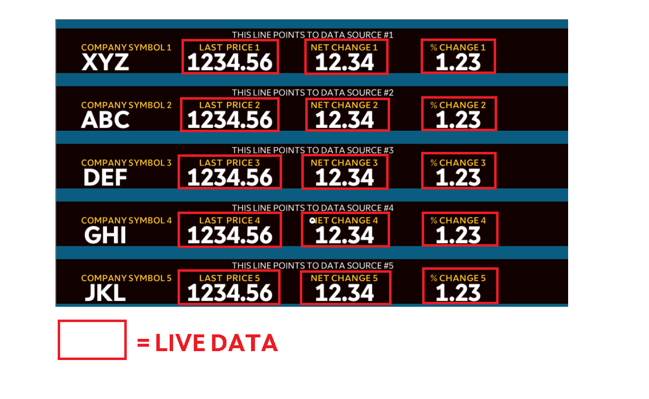

    This is an example of a full screen graphic we commonly use:
    In this page we are using 15 points that connects to live data.  We use this page along with others like it numerous times per show throughout the day.  When we upgraded to Xpression v.9.0 our engineer spoke with Support at Ross and they suggested we use 5 different data sources within our Datalinq to "spread out" the demand.
    If the extensions on the symbols beginning with the back slash didn't change, I wouldn't have to worry about this.  I am just trying to limit editing the "Table Presets" within the Datalinq to 1 source instead of all 5.  All five contain the exact same data.  The only exception being that I want to have all symbols with the back slash on data source #5.  I hope this makes sense.
