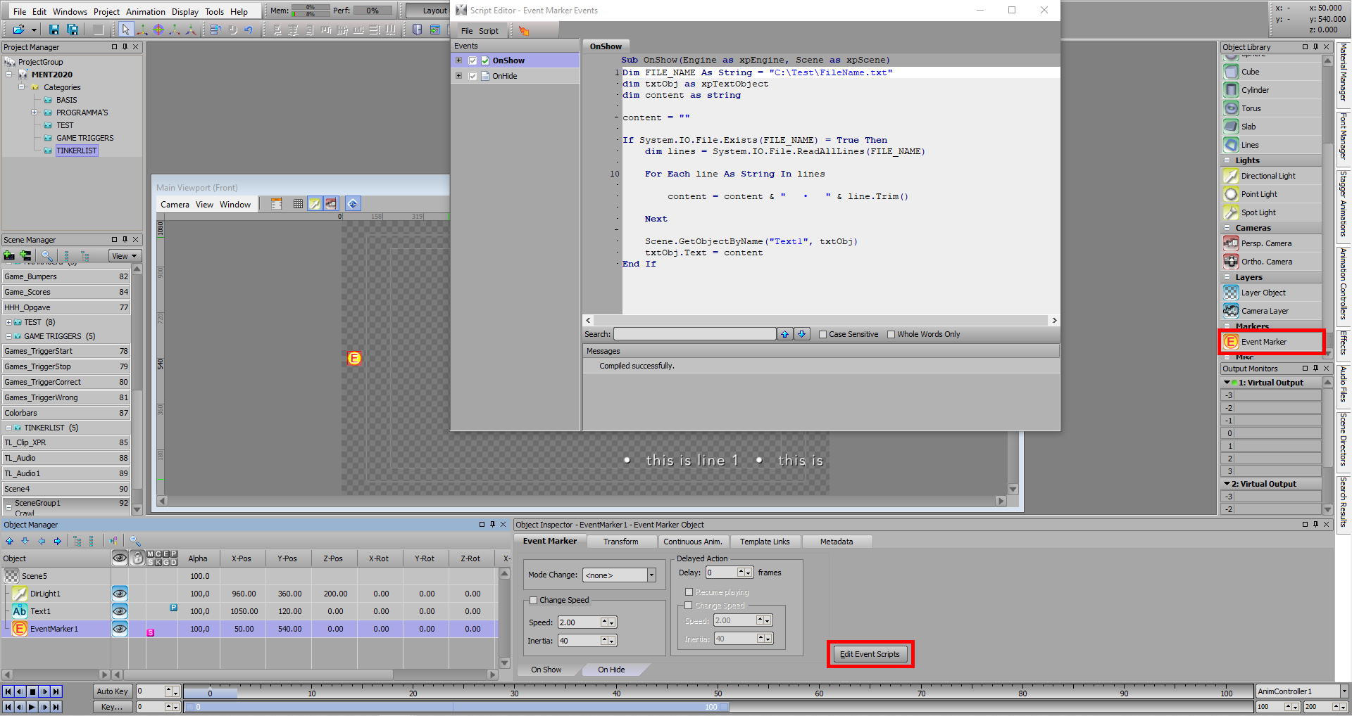

    So add an Event Marker to your scene and in the properties of the Event Marker click on "Edit Event Scripts".
    A new window will open and there you can add the script below to the OnShow-tab:
    dim selectedFile As String = "C:\Test\FileName.txt"
    dim txtObj as xpTextObject
    dim content as string
    content = ""
    If System.IO.File.Exists(selectedFile) = True Then
    dim lines = System.IO.File.ReadAllLines(selectedFile)
    For Each line As String In lines
    content = content & " • " & line.Trim()
    Next
    Scene.GetObjectByName("Text1", txtObj)
    txtObj.Text = content
    End If
    So you will need to change the path of the textfile and also the name of the TextObject you want to use.
    In this example I have used a "•" with spaces left and right to space the different lines of the textfile. Feel free to change this any way you like. You can also use FontTags too if you need to.
    Don't forget to compile the script and you're done.
