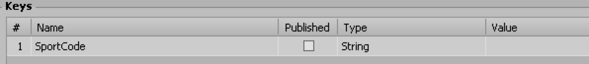

    1. I have a simple scene with a single DataLinq key named SportCode. It is not published, but I've tried that and it makes no difference.

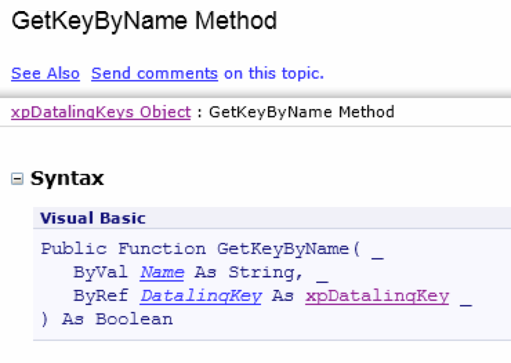

    Is this some v9 bug or am I doing something wrong? It almost looks like the Datalinq keys returned from the function are a copy (ie. "ByVal"), even though the SDK docs say "ByRef", implying that operations (like assigning a value to a key) should be performed on the original objects. Any ideas on this?
