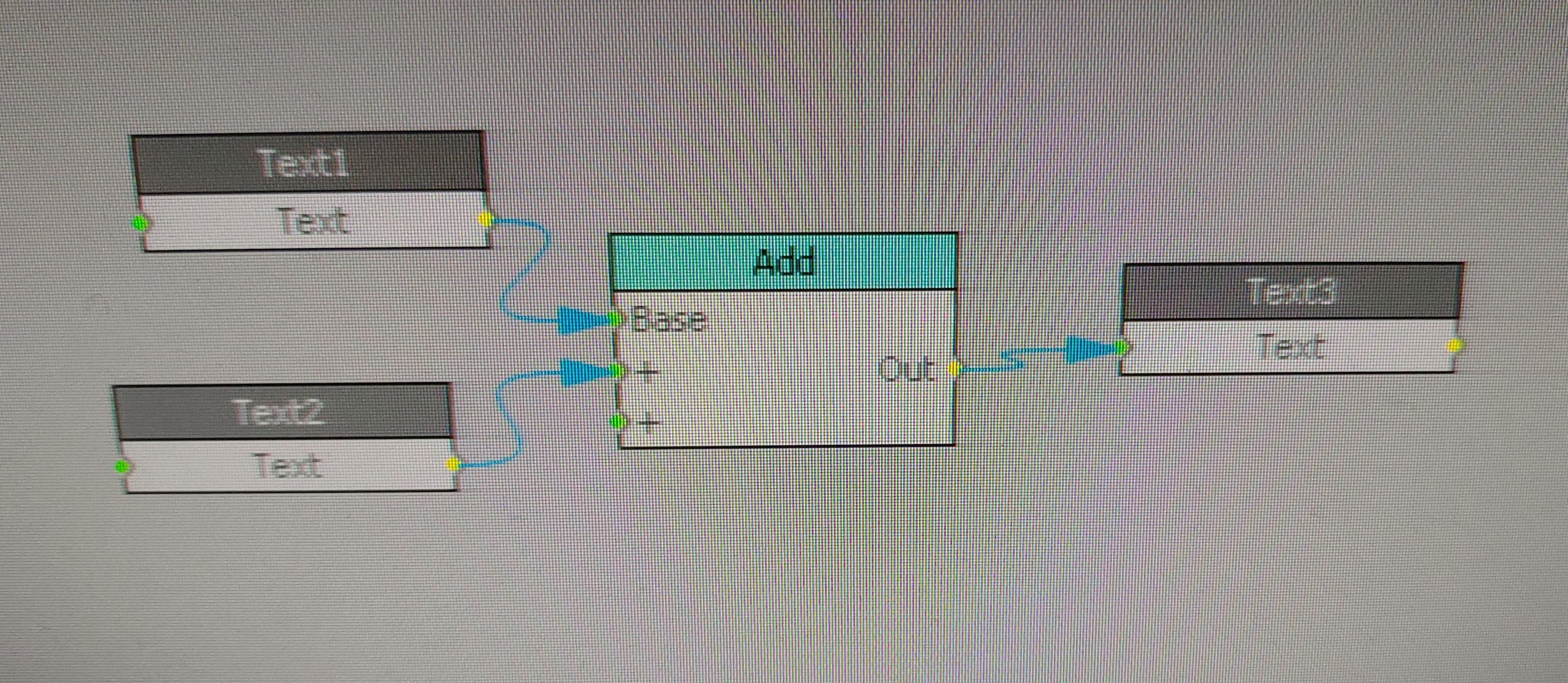

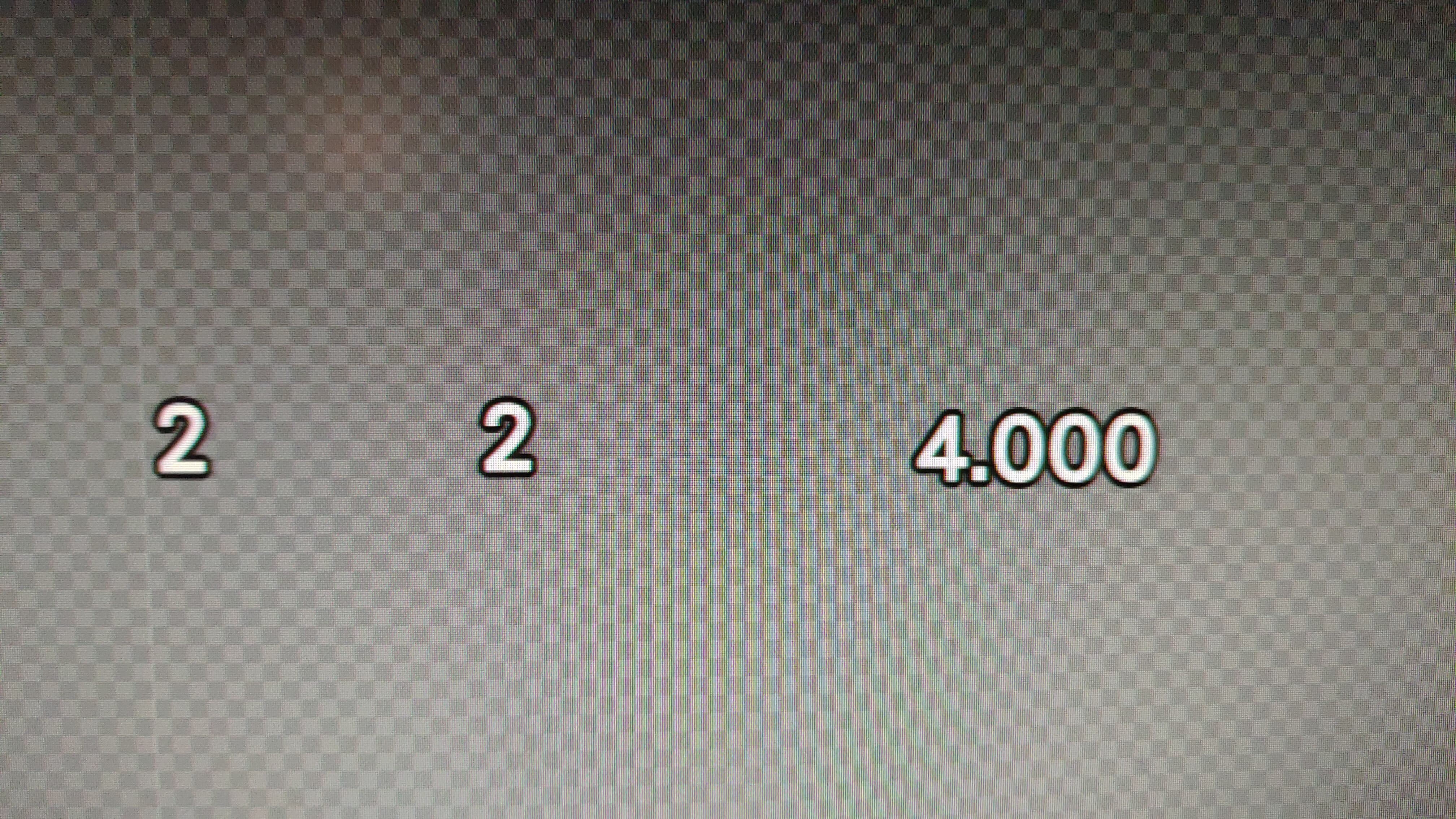

    there is my visual logic text1 add text2=text3, the anwser  is correct,but i don't want to Decimal point,how can i do? appericate

    Add a ROUND function between Add and Text3.

    You can also use the FormatFloat block and it allows you to configure how many decimal places you want (or none at all).
