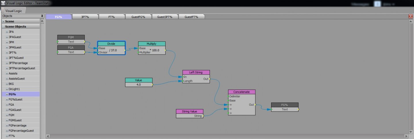

    I am using visual logic to calculate stat percentages for basketball. Currently I am using visual logic to pull data from the Stat Crew XML file. The problem I have having is that in order to display 56.7% I am multiplying by 100% and it does not round correctly when the PA Announcer reads the stats from the stat sheet he gets. When I multiply by 1 and increase the String value to 5 I get the correct rounded percentage, but as 0.568%. Is there anyway that I can have this read 56.8%?

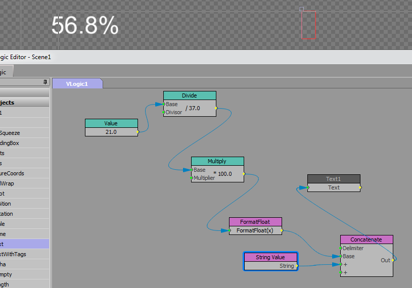

    I would suggest instead of using the "LeftString 4" block, use the Format Float block set to 1 decimal place of precision. This will round the number accurate to 1 decimal instead of just truncating like your LeftString block is doing.
  • 4.  RE: Visual Logic Math
    Posted 12-22-2016 02:06
    Example:
