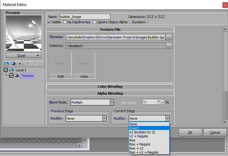

    Personally, I would make an image the shape you want your object to be and use an image mask. Then you can either invert yourself or use this setting to invert.
