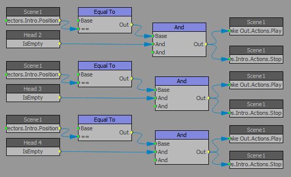

    v1. Create 3 Scene with 1, 2 and 3 bullets and chose the appropriate one when you fill the take items.
    v2. Create a few groups bullets. After the pause verify if the next bullet is empty and go to the end of the scene of play the next bullet.

    You have in the link v2.
    There are 2 scene: 1 - Intro with pauses, 2 - Clean and take out
    You have to put condition when play the first scene: If the scene position is at the pause frame number and the next title is empty then play Take out scene and stop current scene, else: continue.
    Link: https://www.dropbox.com/s/a0qiz7z80zf2mc4/Manage%20Pauses.xpf?dl=0
