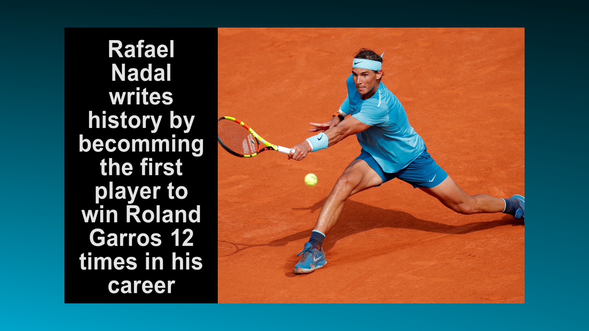

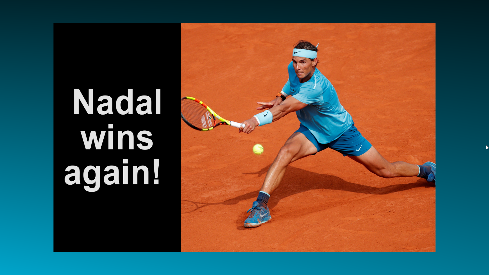

    So for example if the text says "Nadal wins again", I would like the text to be much bigger than when the text says "Rafael Nadal writes
    history by becoming the first player to win Roland Garros 12 times in his career". See examples (https://pasteboard.co/IkFL5sM.png  & https://pasteboard.co/IkFLhv1.png ) to see what I mean.
    Now I have been playing around in Visual Logic trying to get this right using the WordWrap and scaling but I haven't managed to make it work flawlessy. It seems that the WordWrap is not always working the way it should. Sometimes it wraps with a wrong value. Then when I toggle it on and off, it adjusts itself but it's more often wrong than right. So to me this is not the right approach.

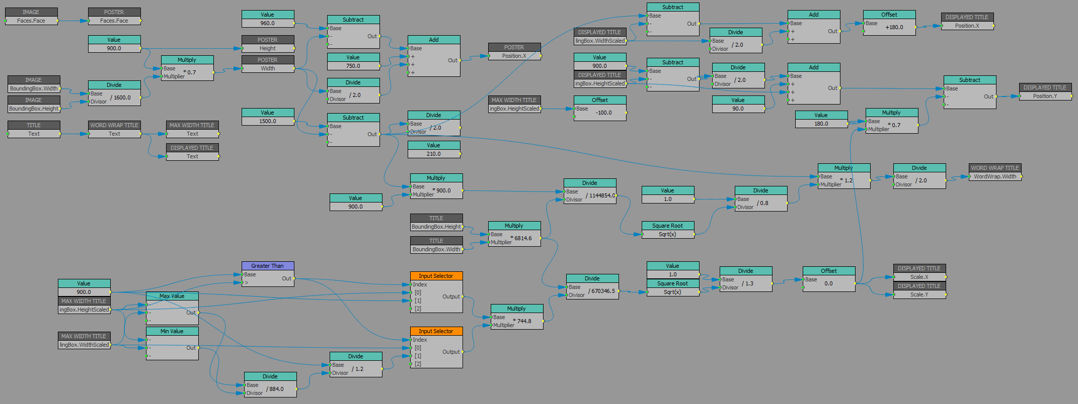

    Ken, do you have a screenshot of the visual logic you have so far?
    You may need to create another tab in visual logic so that the scaling and word wrap is done one after the other.

    Unfortunately, the Visual Logic is very large and is still not working correctly...
    This is my sample, but is not complete.
    Unfortunately, the Wrap function doesn't run well - sometimes it split the words without spaces and sometimes you get different results.

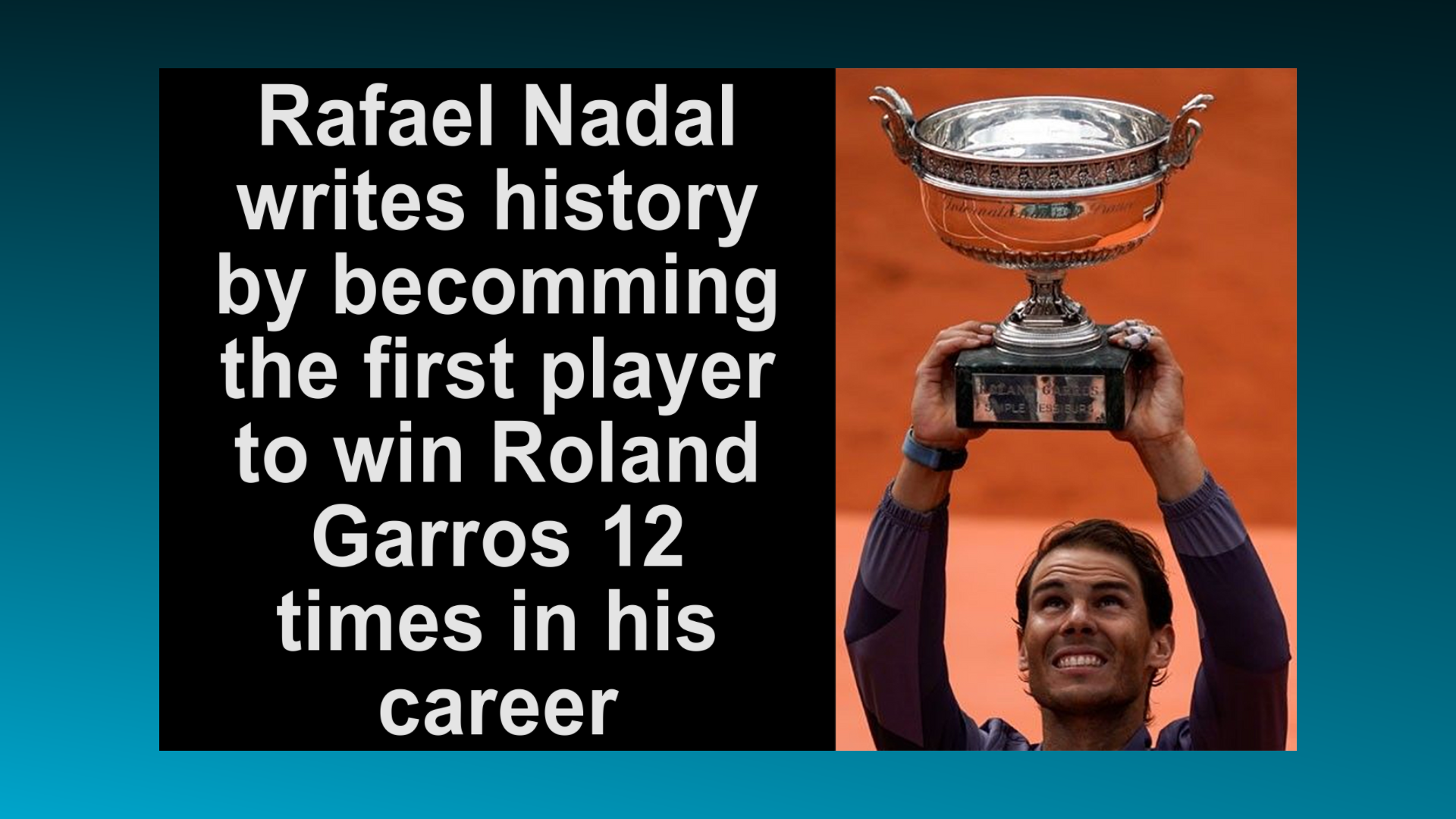

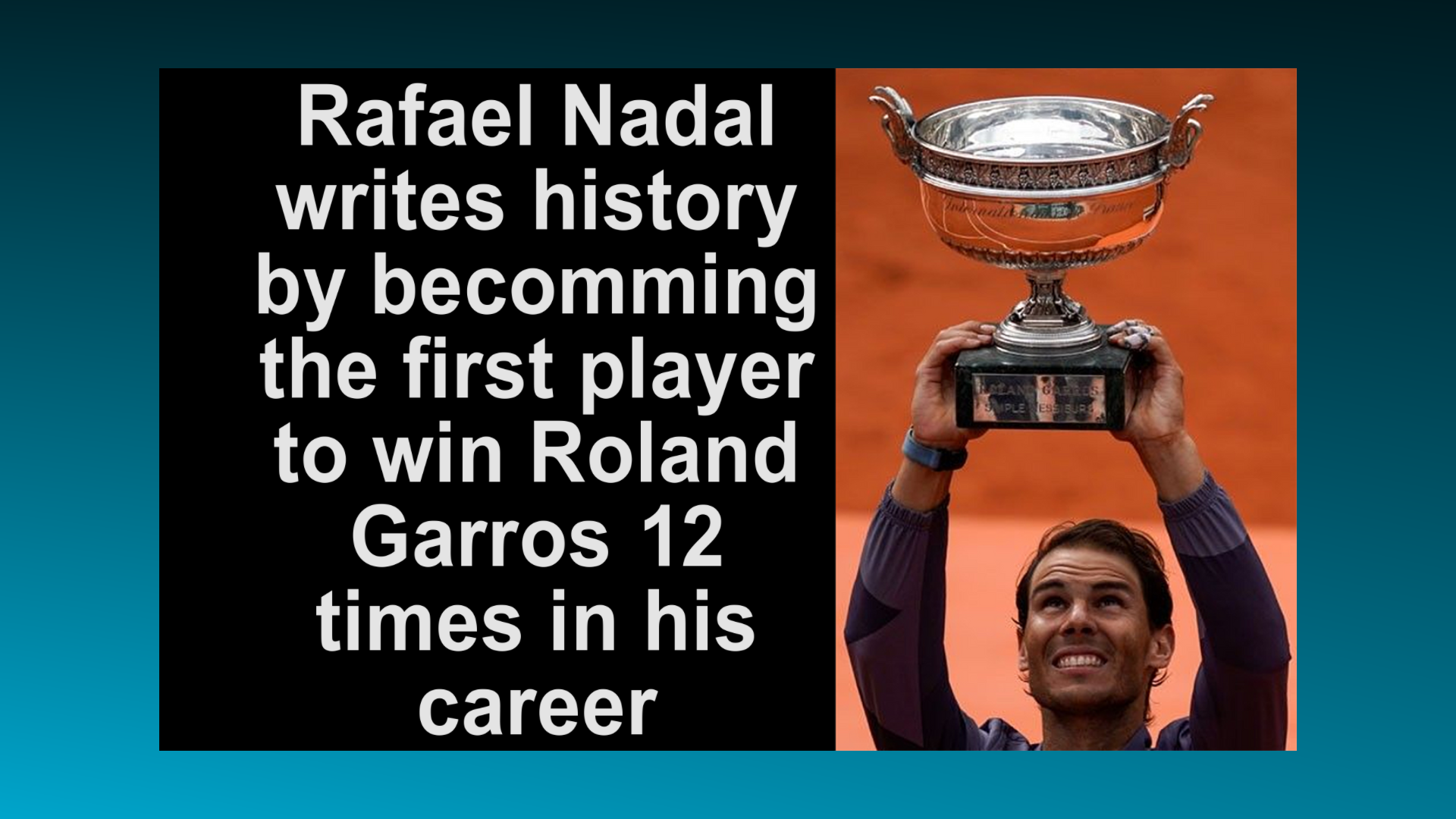

    In Visual Logic there is no order in steps and I decided to try all this in Scene Script :D
    On the community posts I found a short script to wrap the text.
    Without any knowledge in VB, but reading the help area and some other posts, step by step I reproduce the above schema in script.
    There are still some issues, but your titles/examples are looking fine.
    I didn't want to center the title in the frame, just keep it near the image, but you can do it if you want to.
    For evaluation you have the project in this link: http://s.go.ro/ln7yvqvc
    Have fun,
    Gabriel

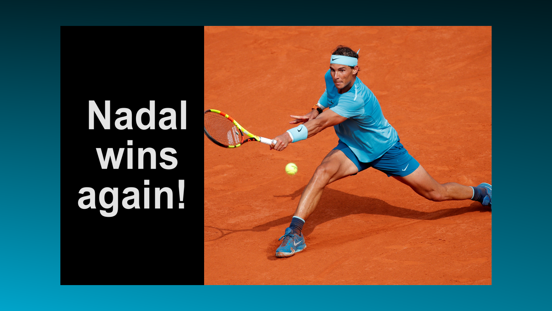

  • 4.  RE: Visual Logic: adjust text depending on size of picture and amount of text
    Posted 07-21-2019 18:40
    And centered title.
    Link: http://s.go.ro/cu9jo24e
