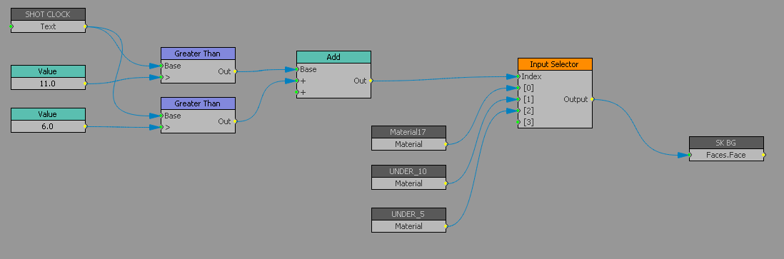

    A while back someone had posted similar with a shot clock changing as it counted down. I used the suggestions from that in VL to make mine and change the face material. If the graphic doesn't make sense, feel free to search for shot clock and it may be easier to follow.
    Basically my under 10 material is yellow and under 5 is red. I would assume a regular clock would be similar.

    Thanks Joshua!
    The visual logic you posted above works perfectly to change the color of the font face.
    The only issue is that my timer runs manually through a widget and I can't get the actual value of the clock to work with the visual logic. In another words, the Timer is not "producing" the right value for the logic to work. When I change from clock widget to regular text and type in the values, it works. But not with the running clock. It doesn't recognize "10:00" as 10, "5:00" as 5, etc etc.

    I just wanted to reply on your remark on the Visual Logic: "The only issue is that my timer runs manually through a widget and I can't get the actual value of the clock to work with the visual logic. In another words, the Timer is not "producing" the right value for the logic to work. When I change from clock widget to regular text and type in the values, it works. But not with the running clock. It doesn't recognize "10:00" as 10, "5:00" as 5, etc etc."
    The reason is that in Visual logic a text is not always recognized as a number as you already pointed out.
    The solution would be to extract the numbers from the clock value using the Mid String-block.
    In this block you can then use the Index and Length properties to extract the data from your textfield which is linked to the widget.
    So to give you an example:
    10:00
    index = 0, length = 2 => output = 10
    index = 3, length = 2 => output = 00
    But in order for this to work, you need to make sure that the output of the widget will always display two numbers for the seconds. So 08 instead of 8 otherwise, you will get wrong results.
    To show you what I mean:
    8:00
    index = 0, length = 2 => output = 8:
    while if you use
    08:00
    index = 0, length = 2 => output = 08
    In my opinion the Visual Logic approach would be the easiest.
