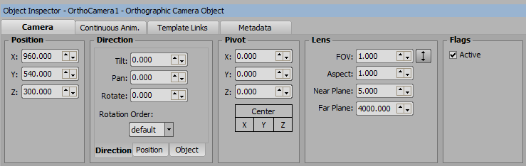

    Under camera make sure you have active ticked or it will use default front view for output.
