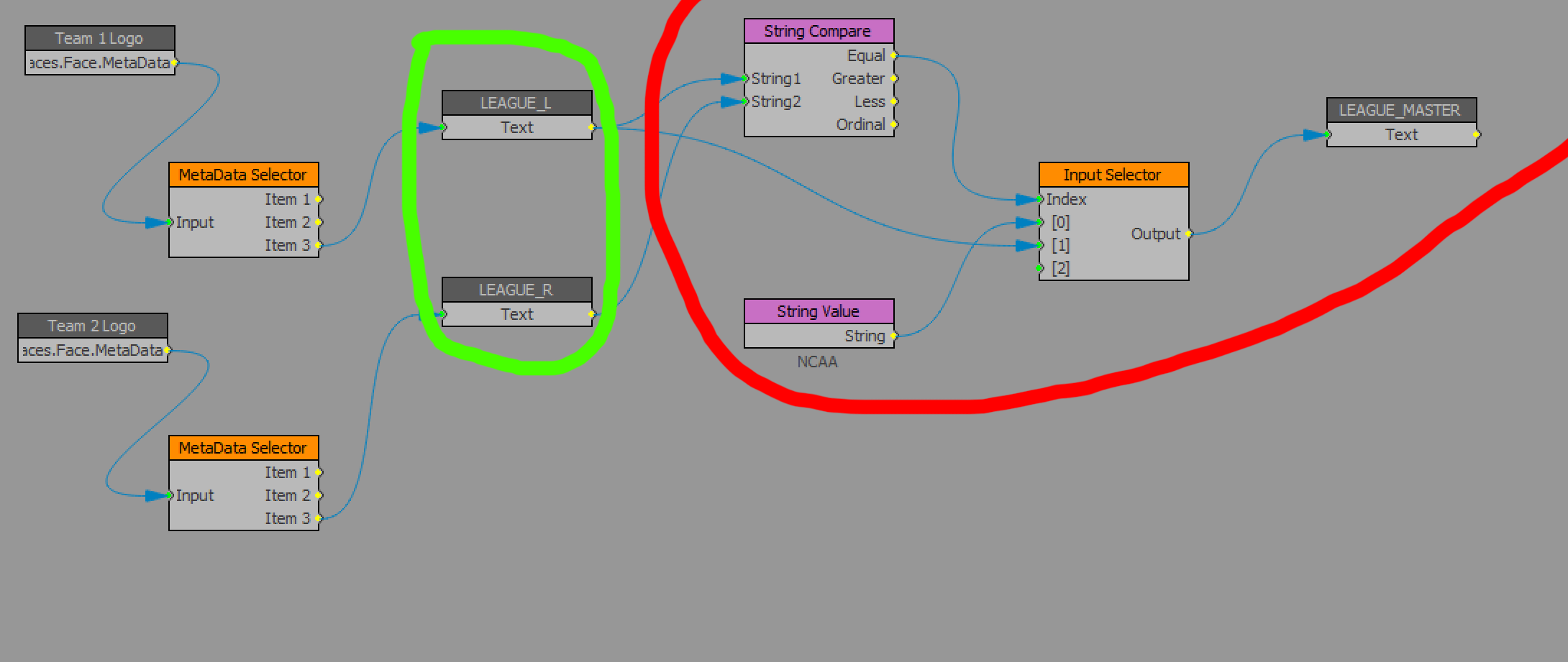

    So, I ONLY want the part in red to run IF both variables (circled in green) contain data (strings). Otherwise, I would like to simply pass the value of the first string to that "LEAGUE_MASTER text object.
    Does that make sense?
    What's happening is it always puts the NCAA logo on screen UNTIL you select a second team (the LEAGUE_R object), regardless of what the metatag for the first object is. So, I only want the comparison of the two strings to occur when they are both NOT EMPTY.
