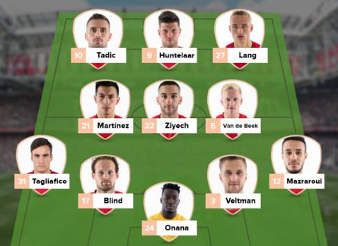

    In Xpression i have a tactical formation with player names and player shirtnumbers like in the supplied image.
    These names and numbers are connected to a text file thats 'textfile datalinqed'.
    Often in a broadcast i have to present up to 5 matches.
    I'm currently in the process of building a new Xpression project.
    For the 5 matches i will at least have to mouseclick my way through at least 10x22=220 Datalinqs to link the fields from 10 textfiles to 10 Scenes.
    A sh*tload of work. Very error-sensitive.
    Looking at the video i mentioned, this must be easier to achieve.
    The question: can i create only one scene with the playnumber and playername fields and create datalinks in these fields, where then i can place the the scene several times in my sequence and fill the fields by choosing a textfield through for instance a dopdown menu?
