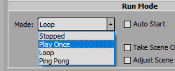

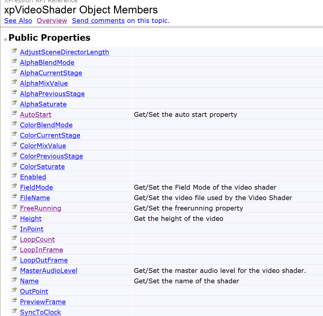

    Posted 03-19-2021 11:50
    Care to elaborate?  I dont see a script that allows me to define the Run Mode: Loop vs Play Once or Stopped or Ping Pong for that matter.
    Blend mode, field mode, loop points, etc.  Nothing that I can see fits what I am looking for.
    Am I missing it?
  • 4.  RE: Scripting the play mode of xpVideoShader
    Posted 03-19-2021 12:46
    Good point, I am looking for a "mode" or something but not seeing it myself.

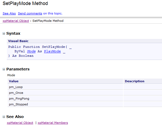

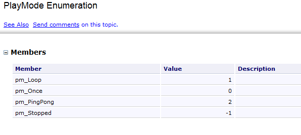

  • 5.  RE: Scripting the play mode of xpVideoShader
    Posted 03-19-2021 15:13
    Mike,
    There's a SetPlayMode Method on the xpMaterial object:
    So to set the play mode to Play Once for a Material on a Quad, a script like this would work:
    dim Quad as xpBaseObject
    dim Video as xpMaterial
    self.GetObjectByName("Quad1",Quad)
    Quad.GetMaterial(0,Video)
    Video.SetPlayMode(0)
