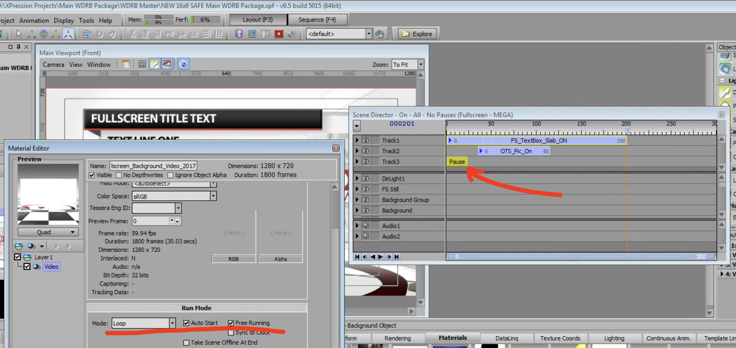

    How would you play out a full screen background to a frame buffer before triggering text on cue?
  • 2.  RE: How to play out a full screen background before animating the text?
    Posted 01-13-2021 14:52
    I'm sure there are multiple ways to do it; but what we do is just have the background layer in the scene, but not in the animation itself. Place a pause at the beginning of your animation controllers so that when the scene first is animated on, the background pops in, then there is a pause to await the animation of the remaining elements.
    If a video background, the material will need to be set to auto start & free running in the material settings.
    Hope that helps.

    Super helpful, thank you!
