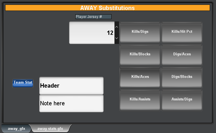

    Bit of a newbie here. Is there a way to send a Dashboard Parameter value to Xpression into a DataLinq Key value?
    We are doing ESPN+ volleyball and the ESPN Dashboard custom panel makes it look like we can enter a jersey number into a spinner, then trigger a take ID of an item which is using jersey DataLinq Key to pull the player data from StatCrew. Since I can't DataLinq a DataLinq Key (as far as I know) to the Dashboard parameter (spinner), I can't figure out how to make this connection between Dashboard and Xpression.

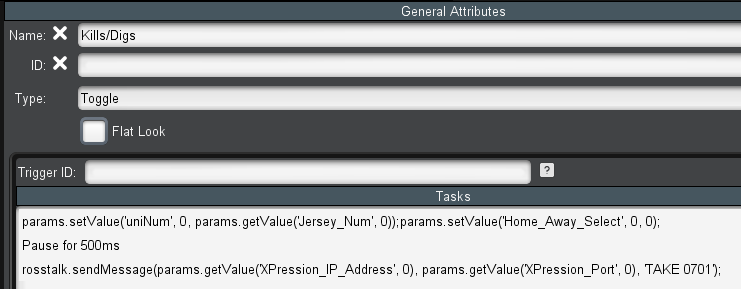

    Above are the tasks of those buttons... I can't figure out where this "uniNum" parameter is used. Maybe that is intended to send it over to the DataLinq key? "Jersey_Num" is the spinner.

    Austin, for a short answer YES. But there are several steps you have to do first.
    1-Create your datalinq keys by name
    2-Tie a hidden text object to each of the datalinq keys you intend to use.
    3-Add a short script that will assign a text input to a datalinq key you have chosen.
    4-Set the data source in datalinq.
    and so on.
