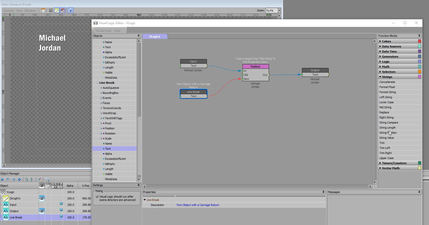

    You can use the Replace function block to search for a space in your Input string and replace it with a carriage return:
    The space is typed into Old String section of the Replace function block. The carriage return in typed into the Line Break text object.

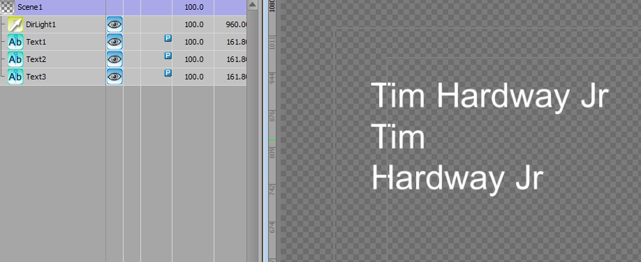

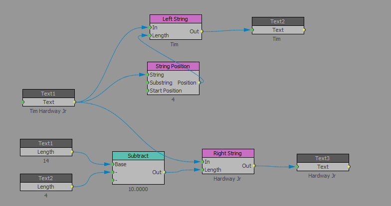

    You can also use the string position block to detect where a space or other item in a string is you are trying to look for.

    You can do this but be careful, some people will not have simple two word names. For example, if your guest is Tommy Lee Jones, the result probably won't be what you want. Separating it using the space before the last word can fail too (Tim Hardaway Jr., Rip Van Winkle, etc.).
