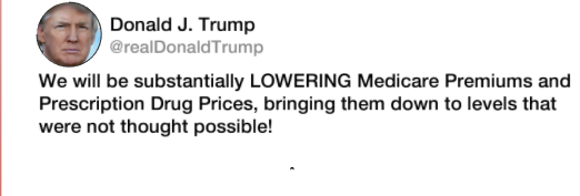

    Is there a way to have a Producer select specific text and change its color using within the MOS plug-in and ENPS?  The real-world example is to give Producers the ability to "highlight" specific text within a quote.  Having the Producer enter the text (or copy/paste) is the easy part.  But often there are times they want to highlight specific words within the quote.
    The un-highlighted version looks like this (for example only):
    The highlighted version would look like this, after they have selected the text they want changed:
