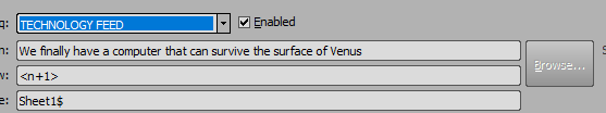

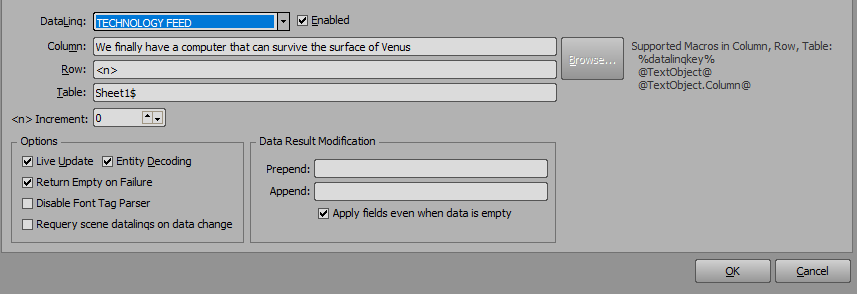

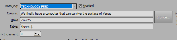

    You replace the number in the row where it says "1" with <n+0> or <n+1> etc.
    so my first scene would have
    the next would have
