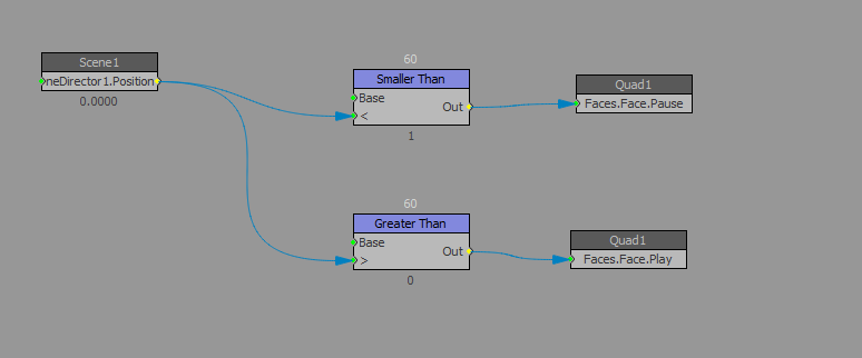

    Another way you can have some control over dynamic materials is through visual logic.
    For example you can get the face values of a quad object such as pause and play.
    You can then get the scene director position property and use greater than, less than etc to control pause and play.
    For example if you don't want a video to play until 60 frames into a graphic regardless of the video you could do something like this.

    @Red Thank you for the visual logic example. That helps me get a little further. The next question is, can I use the visual logic to make a clip play in reverse, like it can on the scene director? Using visual logic is letting the clip on the face of the quad play forward tied to a position on my scene director, but what if at another position, I need a clip to play in reverse? If it's not possible in visual logic, is there a script that can help?
