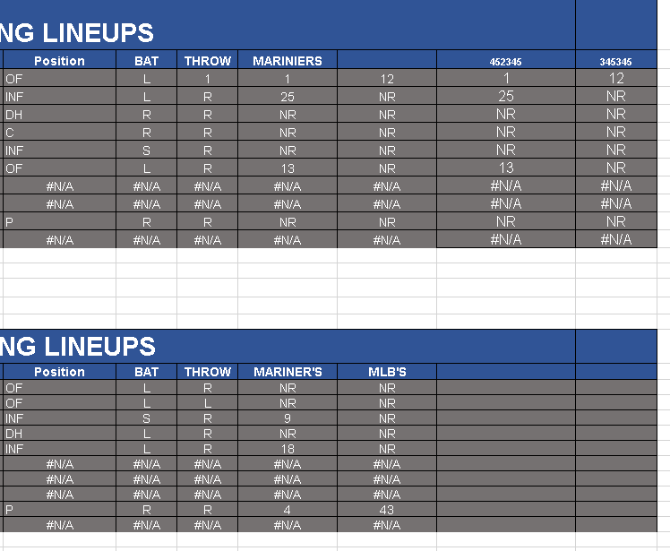

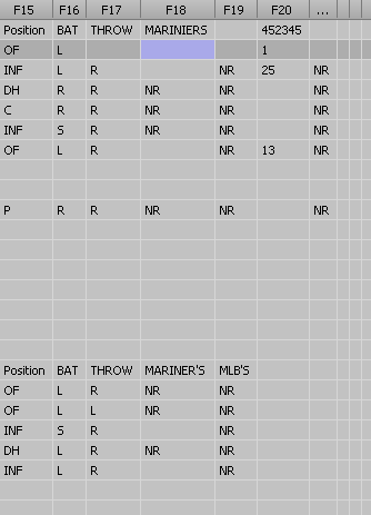

    Here is the DataLinq Field. Under F18 you can see the missing numbers and Under F20 you can see the missing text.
    Here is the Excel sheet that has the numbers and text under "MARINIERS"
