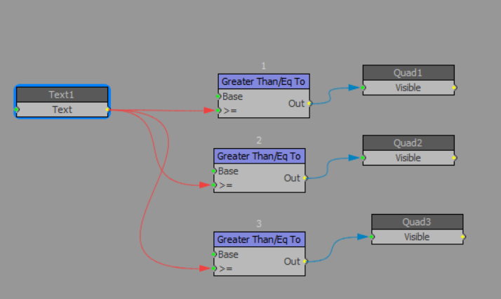

  • 2.  RE: Hide/show group
    Posted 10-27-2020 12:55
    A visual logic that feeds the datalinq'd text into a few "greater than/eq" block and the output of those blocks feed the Visible property of the group.  Like this example, but use Group's instead of Quads.
