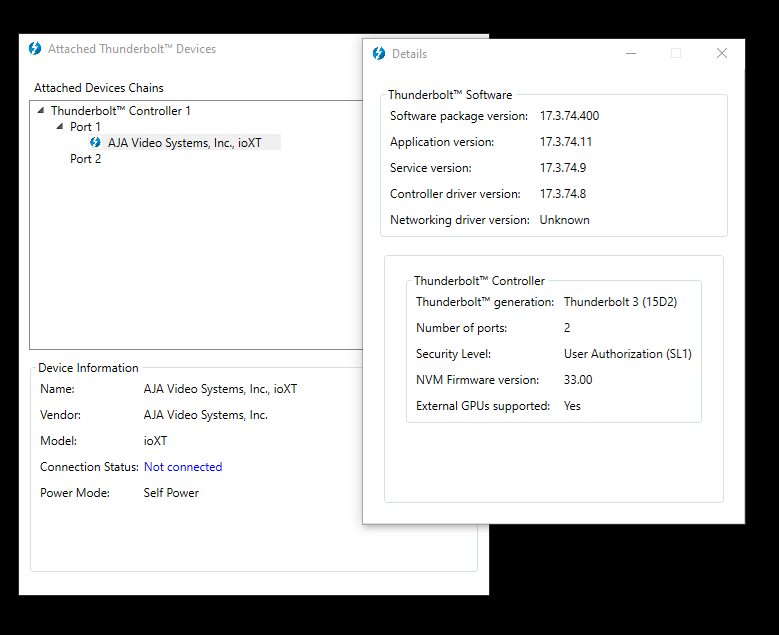

  • 7.  RE: aja ioxt not detected after upgrade to win 10
    Posted 10-05-2020 07:05
    Hi Derry,
    i just come back to office and check again, the IOXT is attached in  thunderbolt manager but the connection status is not connected. I think it is the problem.. so how can i fix it...
    thx
