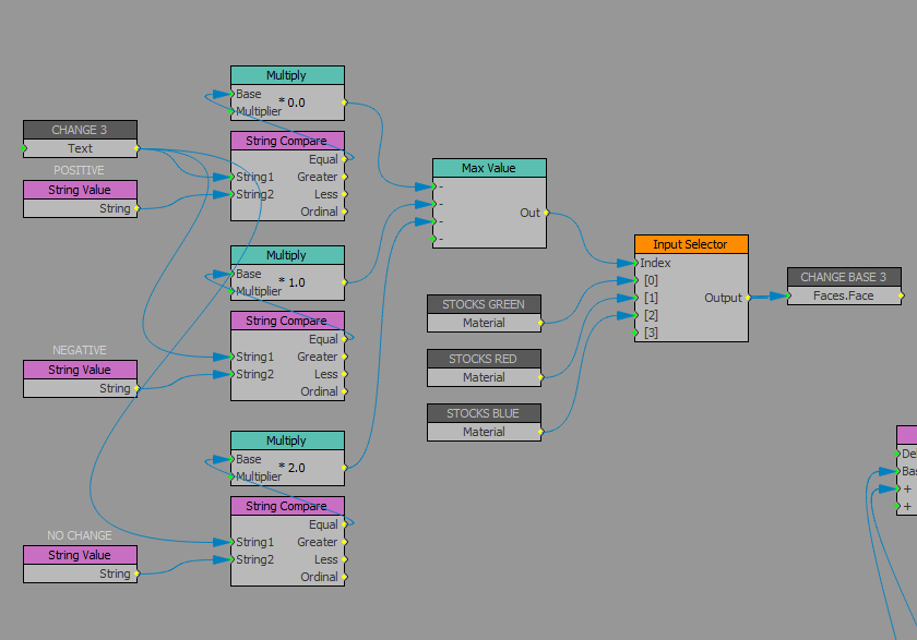

    I do this with the example below. The String value is the word(s) driving the change; the string compare looks at whether they are equal or not, and the multiply/max value blocks are utility blocks so that I can have more than two options. I connect the max value to the input selector and the materials for each word correspond with their number and they are fed to the quad that needs the material. Hope that helps.

    This worked perfectly and makes sense to me. Thank you very much for the example and explanation.
