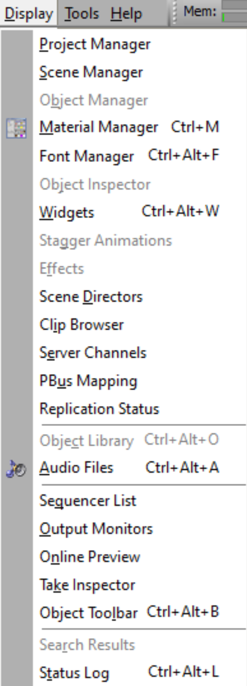

    It's part of the software but a separate license. If you have it you will find it under the Display menu when in Sequence mode.

    That separate license - that's runs the Clip Browser, which Clip Store would fall under, correct?
    So outside of having that license to run clips on servers, the only way to trim clips coming into the machine as materials would be to edit them inside their native software and then export to an AVI in the Xpression Codec?  Just making sure I understand that we are limited in editing AVIs in Deisgner/Studio without that Clip Browser/Clip Store license.

    Correct Clip Store is part of another license, usually partnered with another software called INcoder.
    https://www.youtube.com/watch?v=0BA72S5MieY
    While I recommend trimming your clips before importing you do have one more option inside the software. If you pull the material from the material manager thumbnail onto a scene director track you'll see it will create a green track. This is a reference to the frames of the video and you can simply grab the end of it like you would a layer in Ae and effectively hide the frames you don't want at the beginning or end of the clip. This needs to be done per clip.
