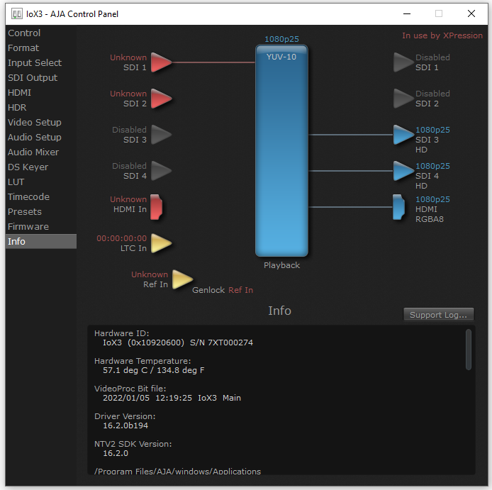

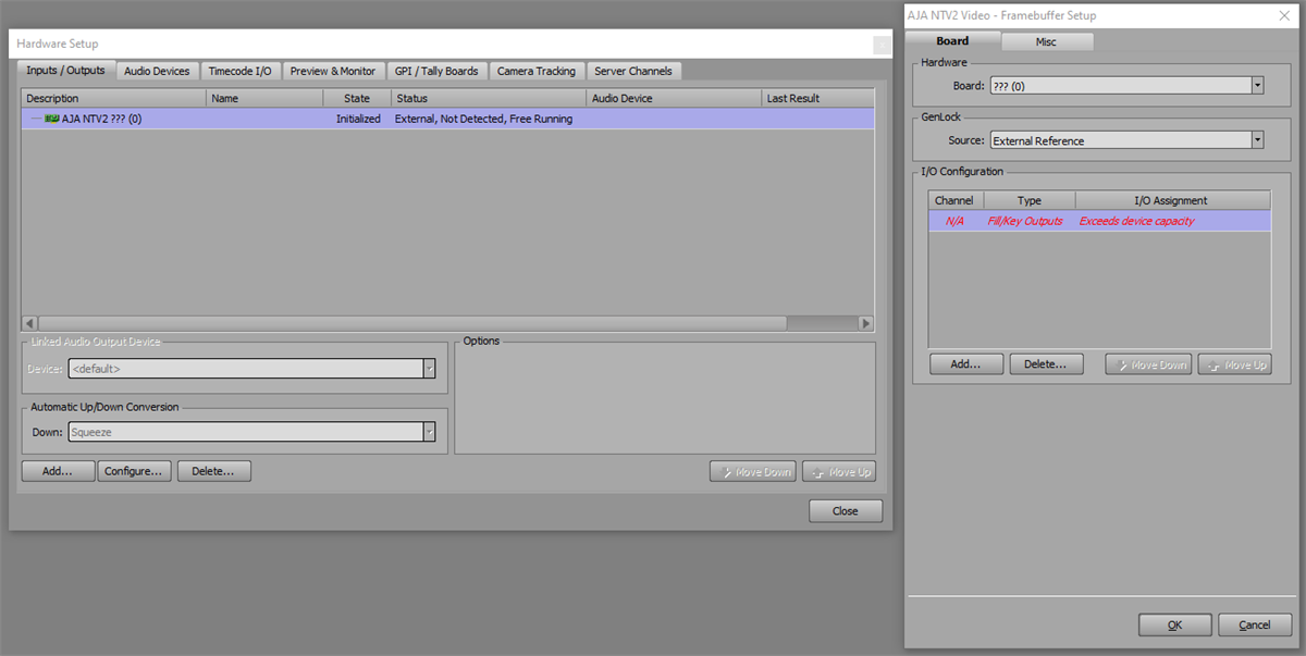

    I have the new AJA IO X3 along with the AJA software v16.2 & ntv2driver-16.2.0.194-Beta1. I can connect the AJA box to my laptop and the AJA software absolutely fine but when I try and connect to XPression, It seems to not recognise the board (???(0)) and comes up with the message "exceeds device capacity" when adding IO. Has anyone else experienced similar issues?

    Which version of XPression are you running? You will need to run XPression 10.7.5575 or higher in order to use the AJA 16 drivers
