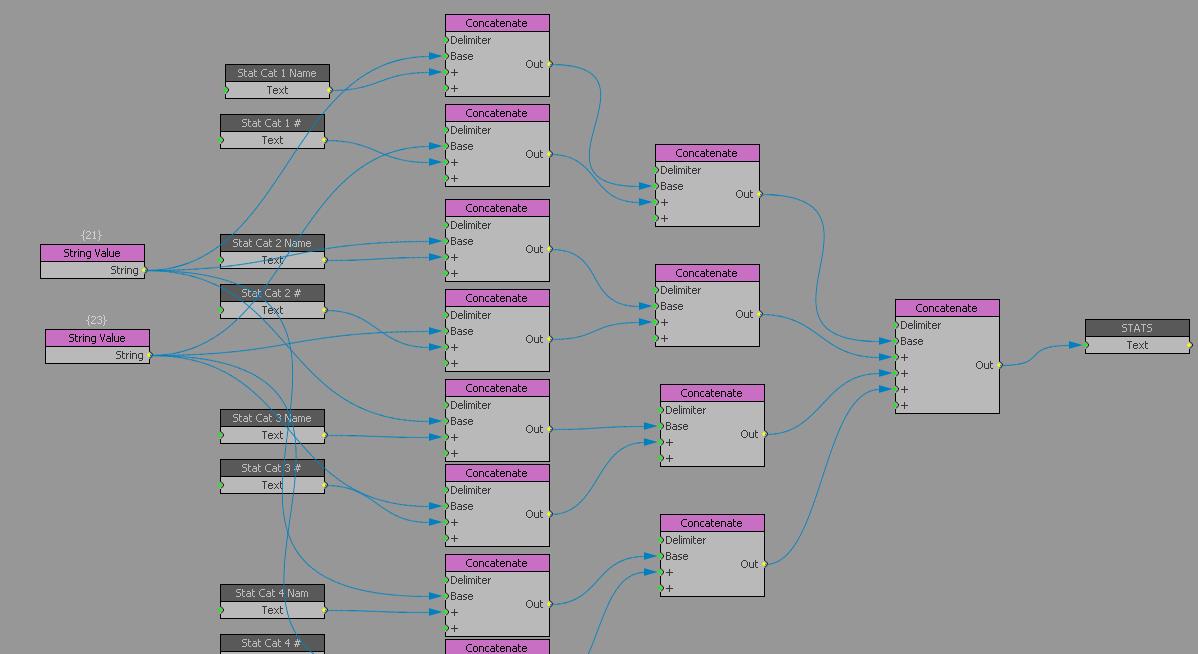

    I'm making a stat lower third with stat categories/numbers. The design calls for two different font sizes for the category and number. I've got it set up with {font} and concatenate in Visual logic, which works great - except I don't know how to align the text vertically, instead of it aligning the the bottom. How can I do this? Can I do that while keeping it set up in concatenate? Appreciate any help.

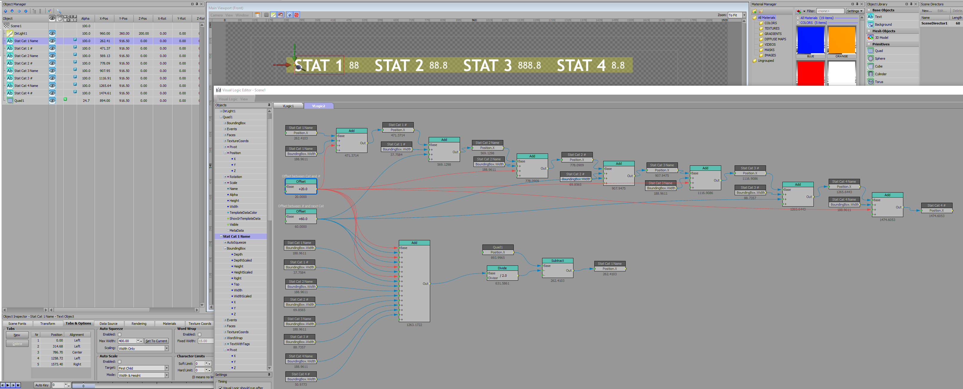

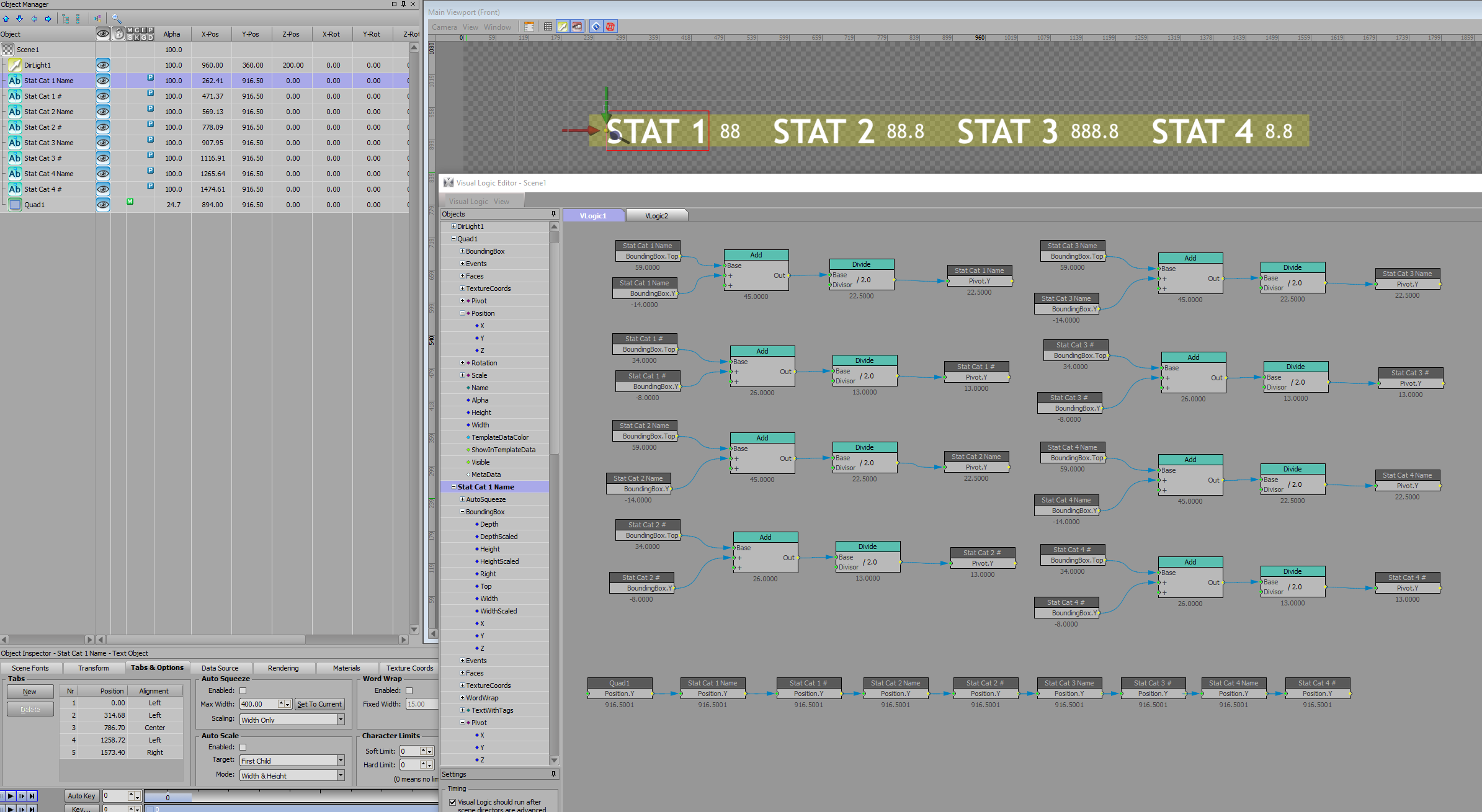

    Here is some fancy Visual Logic that will keep everything always aligned perfectly to your Quad. No need for Concatenate blocks here. You can move the Quad anywhere you like, resize it, change the Offset values in VLogic2, use any font(s) you want for any object, and it should always stay aligned so that all text is centered in the Quad both horizontally and vertically. Just need to make sure all your text objects are Left Aligned (Tabs and Options>Tab 1>Alignment column dropdown>Left), and their Pivot X values are set to minimum (By default, these should already be set, but if not, then right-click on the Text Object in Object Manager>Pivot>X-axis>Min. Do this AFTER setting Text Alignment).
    VLogic1 covers Vertical Alignment and VLogic2 covers Horizontal Alignment.
    VLogic1 4 cats
    VLogic2 4 cats
    If you need to animate it, you can put everything in a group and animate the group.

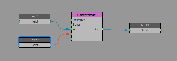

    The simplest way to do this would be to concatenate multiple text boxes into a single box and then that one can be treated as any other single text box.
    Someone may have a smarter way but this is certainly the easiest.
